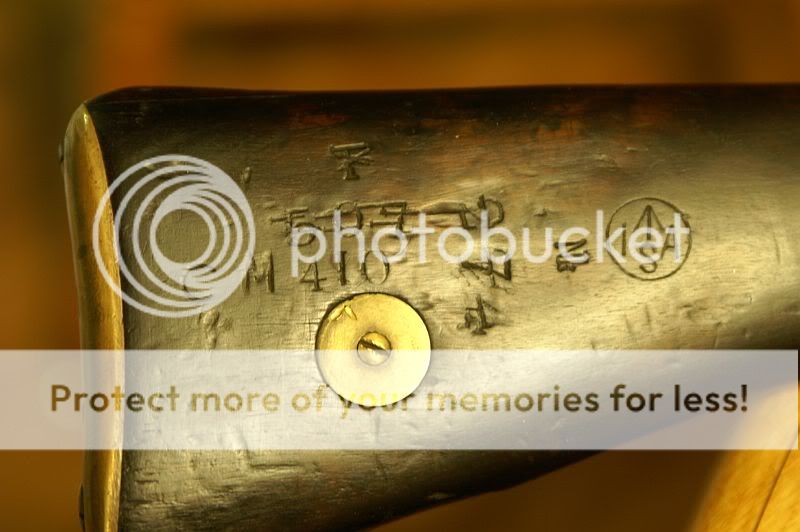

I bought an oily (understated) old 1941 RFI .410 at Yorkton on Saturday, Feb 27. Other than having soaked up a barrel of oil and maybe been dragged behind a truck for a little ways, the old girl is matching. She was made in England in 1917.

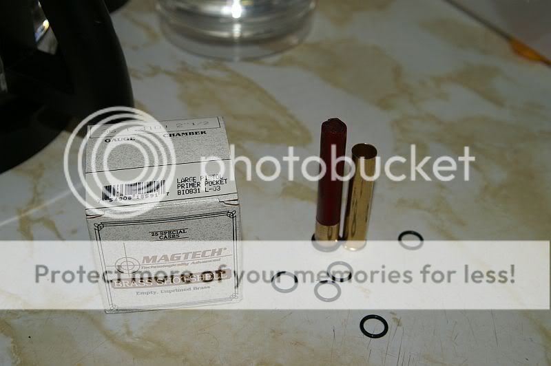

.410 rims are thinner than 303 rims. Had the same problem with my .410 SMLE. The fix is to use o rings around the base of the shell thus forcing the base onto the bolt head.

Lengthening the firing pin might be an option. While at the Yorkton Gun Show, I spotted these MagTec cases, presumably meant for these old pelters if they haven't been fixed for 3". Note the o-ring on the 3".
Has anyone any experience using these brass cases, i.e. crimping or???

My friend and I went up north to his cabin at McBride Lake yesterday, and in the afternoon we went out and killed a beer can with the old Ishy. The o-rings worked like a charm! No misfires. We only fired four rounds, as the beer can likely died after the first shot.
