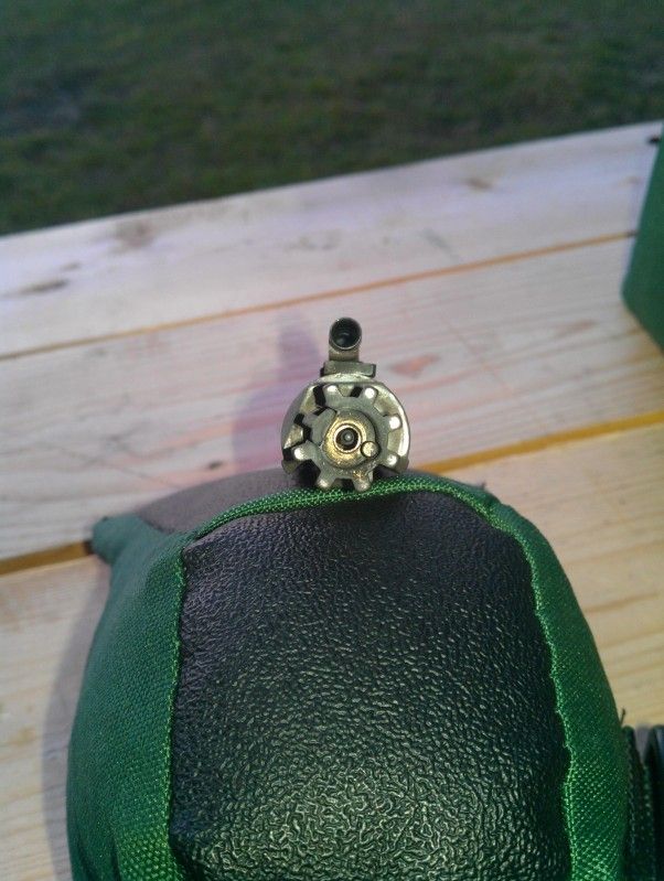

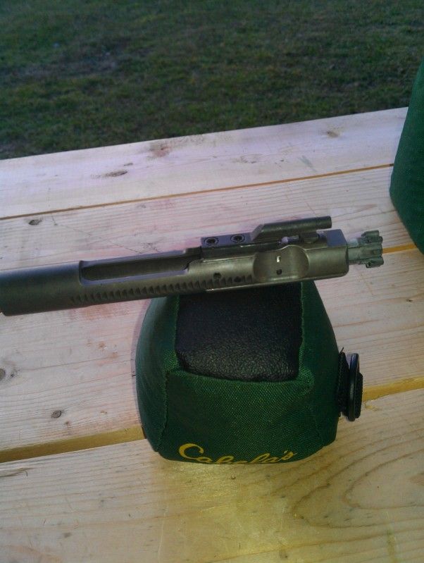

At least it wasn't the lugs like they are known for....this one appears to have the firing pin channel drilled too deep so there was no meat in the bolt face. 3rd round fired in a new Bushmaster 20" upper. Bought the bolt and carrier from you a couple months ago for this new build.

Huh, that's not good. However, that looks like a whole lot of brass residue left on the bolt face, what cases were you using?
Nork factory ammo, 55gr fmj. Yeah its crap ammo, but I got 300 rounds through my DPMS with zero issues.
I know better too, and I have another good bolt, I really only wanted the carrier.....but all the chatter about NEA correcting their mistakes made me give it a chance. Claiming the bolts are MPI and proofed is obviously bull####.

I'll take a pic of the case when I get home...the middle of the primer blew out the same shape as the hole that let go in the bolt. Rest of the primer is intact. I don't even know what parts NEA actually manufacture. The bolt had a small E stamp, and I've seen that.before about 10 years or more ago.
Hopefully they didn't #### up the carrier and I get some use out of that at least.
The ARF handled it well though, bit of warm air in the face, smoke outta the mag but that's it.
