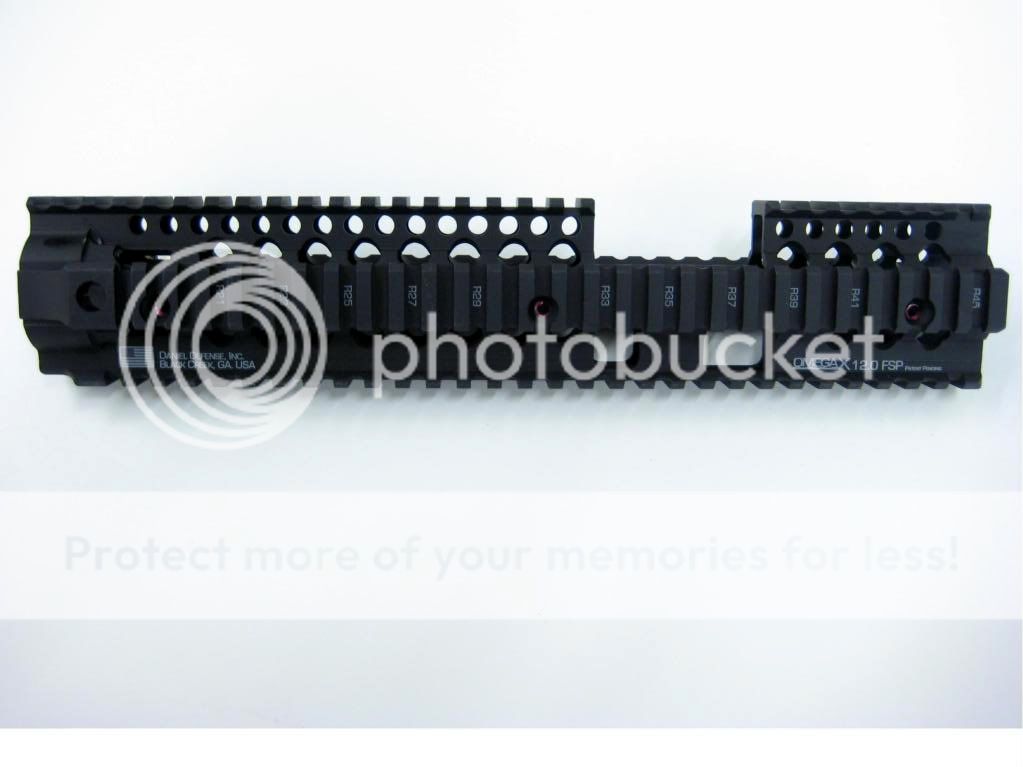

You could go with a rail that has a cut out for a fsp but is a longer rail.
