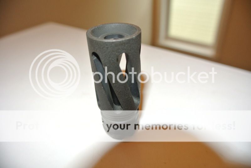

Here's a picture of mine.
And one of the locking pin slot which has been peened over by the locking pin cause by the rotational force of the muzzle break.
I've got one that looks just like that that. I wouldn't be surprised if they just got the drawing reversed.

From Stevo's description looks like you have the early version that worked. If you compare the vortex slots on yours to mine in the picture, you will notice your slots twist the opposite way.
