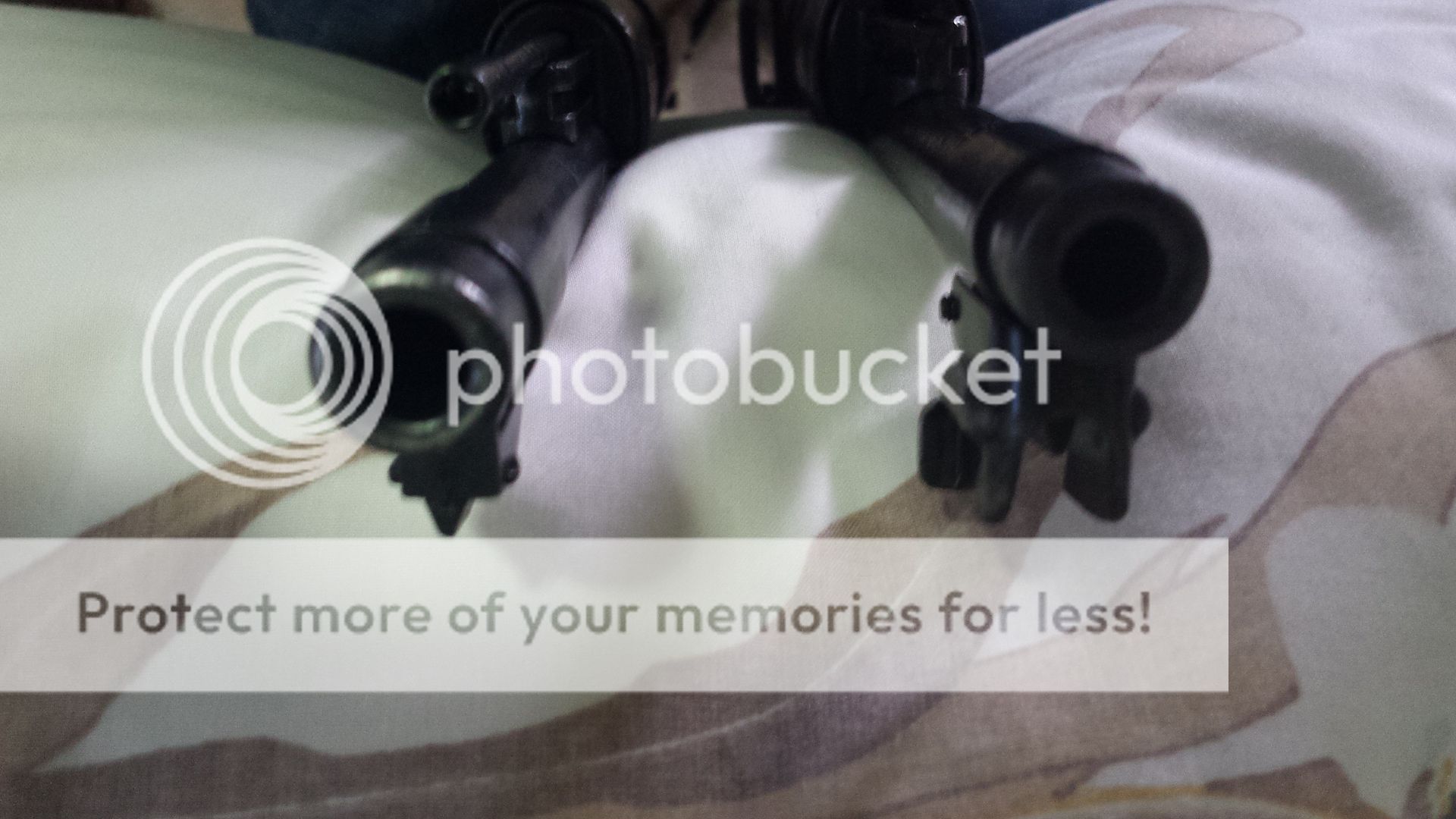

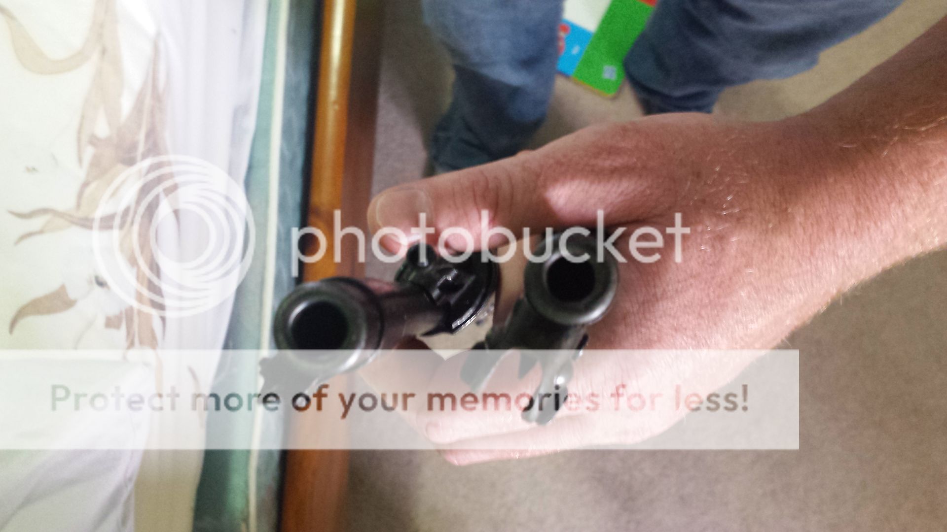

May have averted an unfortunate accident, listed a mauser (one with the sight hood) on EE and had two interested buyers this morning chomping at it. Decided to hold off and do more research on it. He lt it side by side with my other K98 and noticed this below.
I do not have an ddnn accurate barrel calibre Guage. Is the smaller appearing barrel diameter perhaps .308 or 7mm? Or is my other rifle rebored?
Shaking at the thought I could have sold someone a rifle telling them it was the wrong calibre. Yes I know they should check too but yikes

It's a VZ-24, they were made in many calibres. What are the markings on the chamber?
EDIT: Never mind, looked at your other post, it's just a VZ-24 sight protector. Oddball rifle - suspect its an 8mm, is your other one counterbored?
There were (and still are) VZ24's that were rebarreled to .308 available from several dealers. Not sure how they are marked?
This is a K98 or was a K98 everything of significance that would help has been "buffed" off in the postwar process. Materials used tell me it is late war, stock has a 45 and a 3 or 4 digit number below it on the underside of the stock. Nothing at all on the rifle to suggest the bore size. Heading to Canadian tire out of curiosity.
If it's not 8mm then I sure hope it's .308 over something obscure

Wierd they measure the same.... actually the one with the sigh hood is exactly 7.98mm where the one without the sight hood is 8.01mm both withing 8mm standard variance. Optical illusion maybe
(1945)Sight hood rifle measures 7.98mm
(1944)Non Sight hood measures 8.01mm
difference per year of war 0.03mm of rifling? the human eye is pretty perceptive at differences but wow small differences.
This is with my Mastercraft CanTire Caliper tool (On Sale now for $21 for those interested)
