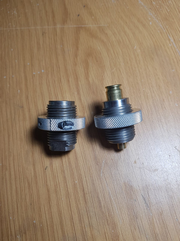

My gunsmith made my 6.5x47 and 223 case holders. Just steel rod turned down and threaded, with a chamber cut in. Very simple.
I believe most if not all sizing dies are hardened, so opening up one with a reamer won't work. If you have the reamer, you'd might as well make the holder from scratch. Cheaper and easier then modifying a die.
Forster lock rings for ease of adjustment and changing between them.

EM Precision in Spruce Grove. Any gunsmith should be able to make them no problem. If possible, I would recommend using the same reamer that was used to chamber your rifles. But since you trim after sizing, this really shouldn't be an issue either way.
Got the lock rings from Hirsch.

You could probably get it made out of a shot out barrel in that caliber too. Just have it cut to length and the outside threaded.

A piece of B-7,Grd 8 equiv All Thread rod purchased in 3ft length.
Face sheered end & part off a stub length in a lathe.
Face the parted end & ctr drill to pre drill prior to reaming.
Ream or bore for specific case.
I use the Giraud for bottle neck cases & a Gracey w/ indexable insert for straight wall/rimmed cases.
1 holder was purchased w/ each unit when new.
dozens of case holders manufactured from Hornet to 50BMG & 38spl to 454Casull.

Very simple to make. Just thread a piece of old barrel and run your reamer in. Actually is way better than a bought one
The insert on Giraud is spring loaded..it is not just a chamber.
They sell blank..
Having a gunsmith make them will cost way more than order the part...
