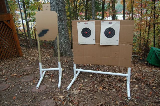

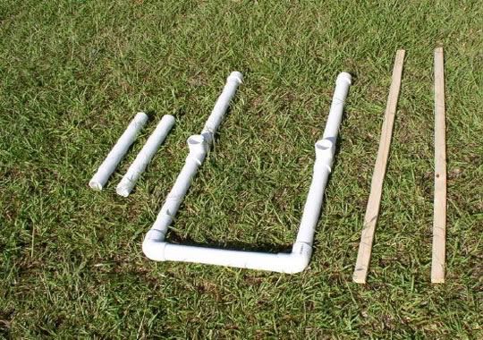

on that 6mmbr.com site they had an article on an abs pipe stand that worked, I will see if i can find the week of the article for youl I have it copied somewhere around the garage jeff
