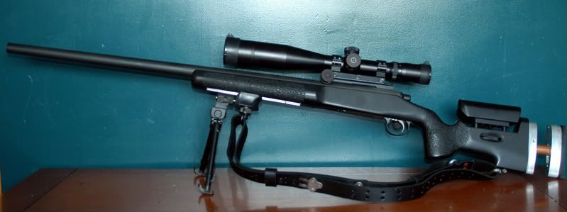

Hey guys, I recently just aquired a tactical .308 . didn't really need it, but it was already set up nicely, (sniper stock, 50 mm mildot illuminated scope, Rem 700 ported and braked) Very confortable to shoot from prone. I am looking for a good longer range Deer rifle.. I am used to the .325 WSM. Big difference here... what is about the best kill range I can gain out of the .308 , keeping in mind handloading is a very viable option for this round. :) I do NOT punch paper really at all, just for initial site in. I am slightly more UNFAMILIAR with the .308 round , like I said I have always used mags. Some people go both ways. just need some opinions from guys that have more experience.... any thoughts would be great... THANKS :)

haha.. I do understand that tactical "heavy" rifles make silly hunting rifles..I do find that they are far more comfortable to shoot. However I will have 2 rifles... one for walking and quick shots, "eyballing" the target at closer ranges to 250 - 300 yards.. the .308 being heavy and cumbersome, is going to be set up as a "LONGER RANGE" where there is more than enough time to setup, lay down , take my time and make the adjustments needed for a clean kill at further distances. I am hoping the .308 will do for now untill i can get the .338 LM set up, built etc.... they are pretty pricy... soooooo could take some time.. haha..

1 in 9 inch twist is what I am at for the barrel . looking for some good heavier projectiles that people have had experience with Hunting... Realistically I will be looking at 600 - 800 yards max with the rifle... especially being that field conditions will be LESS than optimal for trajectory prediction to be perfect. but hey ya never know.. we might get a perfect day.............. Thanks for the opinions thus far guys.
