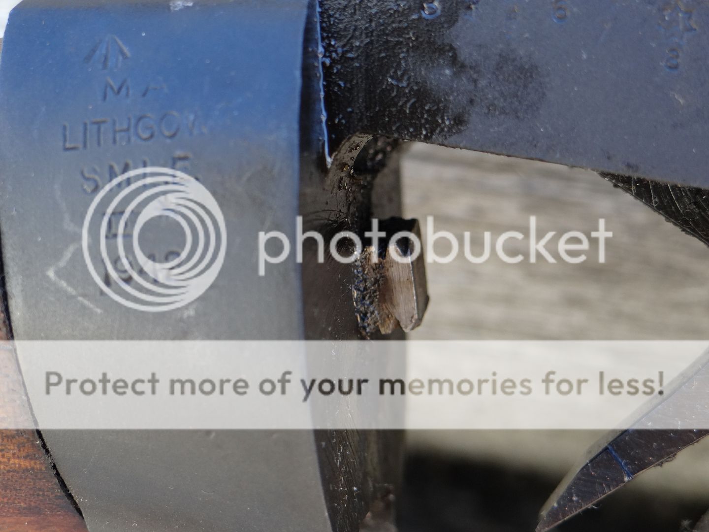

I have a 1942 Lithgow SMLE that the owner wants cleaned, and my preference is to remove the stock and let it bubble away in my ultrasonic cleaner, and as a rule Lee Enfields don't give me a problem. When I couldn't budge the butt stock retaining screw, I decided to strip off the forend which led to my first problem, then let some penetrating oil seep into the threads of the stock screw from the magazine side, which is when I ran into my second problem.
Problem number one is the trigger guard screw, the screw threads stripped, so while I've got a spare on the way, I'd like to know what the thread pitch is and find a tap to chase the threads.
Problem number two is what I found behind the magazine when I expected to see the open ended extrusion for the stock screw . . .
So the question is, should I expect to be able to unscrew the stock screw? I'm anticipating cutting the stock so I can put a wrench on the screw shank to unthread it, and replace the butt stock, but is it reasonable to expect the retaining bolt to thread back into that thing?
Your picture is showing the absolute correct installation of a butt stock bolt for a No. 1 Lee Enfield. You are lucky you could not turn the butt screw - it is meant to be lodged tightly into a slot in the back end of the forearm. People who do not know that you must remove the forearm first, try to turn that screw and split the rear of the forearm. Hoping that you knew to remove the forearm straight down - at nearly right angles to the barrel. If you pryed off the forearm tip and levered it off like on a single shot shotgun, you really need to do careful inspection of the draws - that fit, between the stock, the draws, the wrist and the floor plate is the heart of the Lee Enfield accuracy, along with the forearm tip bedding.
I have found these square ended No. 1 butt screws installed in Parker Hale No. 4's, so I assume they will also interchange the other way
Thanks for your help, once I figured out the screw was a square shank, unthreading it wasn't difficult, with no damage resulting.
