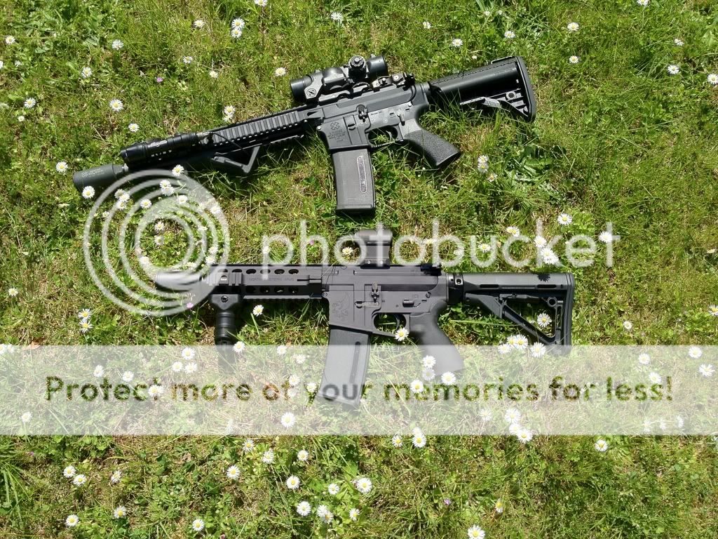

i have a NEA 7.5 rail gathering dust.... pm me if you want it...you get the shipping...
here it is with an XB1 setup...
and again... bottom rifle
Would you reccomend going with a 7" (or close to), or a 9" rail? I'm not even sure if the XB1 will ever show up, the order has been "processing" for the past week haha :s
With the 9 inch rail my XB1 is about 3/5 covered by the rail. An 8 inch rail would be better to see more of the XB1 but the 8 inch rail is not as easy to find. 7.2 troy rail may show a little of the barrel with a gap between the end of the rail and the start of the F/H.

Try the Samson Evolution rail from Fabrice at Fabsports.ca For a 7.5" barrel, I would buy the 9" rail. I'll post a photo to illustrate but it has no problem fitting over an XB1.
