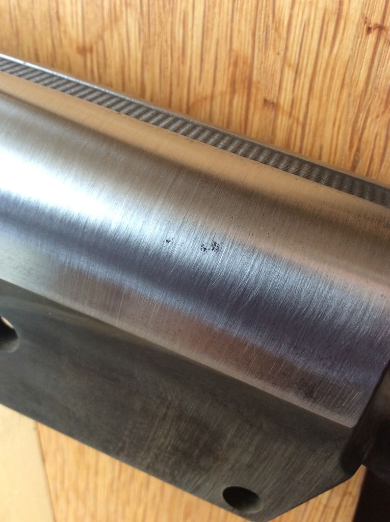

Hello everyone,
I am preparing a R.A.S. 1906 (later known as Remington M11) for rust bluing. Beside the cosmetic apparence how far is it necessary to remove the small pitting into the metal? Is there a danger that those small rust pits reappear (rusty) after the bluing process or will they be neutralized?
Thank you for your help
Thank you Wyrhare,
I am assuming that the fine glass beads blasting will give a mat finish? I think some deep rust pitting may remain but it will be hidden by that "frosty" finish. I am not sure if this will occur thus I am still trying to find a response to my original question! My intention is to achieve a more shiny finish therefore I am going to sand the metal up to 600 grits.
Thank you again for your help
Couple drops of muriatic acid will burn that out in a hurry if you are real concerned, but I wouldn't go to the trouble. Pit will be there regardless. Don't forget, when you boil rust bluing, you anodize the existing rust. What's in the pits and all.

Draw file that pit out , sand to 320 grit . If you go much finer the acid will not "grab" the metal and you won't get an even job.
