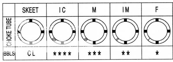

Your shotgun should have choke marking on the barrel, either with letters or with asterisks. Though I am not familiar with the Saiga.
Yes, I figured that out after a little bit of researching lol, the barrel says 12gauge 2 3/4 F.
I'm guessing the F stands for full choke?

On my Boito shotgun the markings are "Y's " instead of *'s . The markings would normally be on the underside of the barrel, you may have to take the barrel's off to see them.
IC - improved cylinder
M - modified
IM - improved modified
F - full
