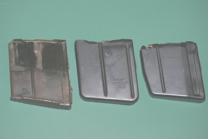

Those are the 3 7.62 mags for Enfields. 2A, Sterling conversion and Enforcer.
