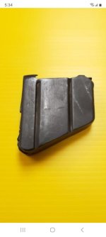

Got my grandmother's . BSA 1918 .303 british and it is missing the magazine. I've looked up magazines and seems to be a few to choose from. Anyone know the one I need
Cheers
The full size magazine is a 10-rounder. There also exists commercial (and homebrew) conversions where they chopped the magazine to 5 to be closer to a flush fit with the stock. I'd get the 10rd mag personally.
The correct mag has two locking notches on spine instead of one notch, they are for no.4 and no.5. Also the grooves on side running all the way to bottom instead of stopping just short of bottom edge of mag.
