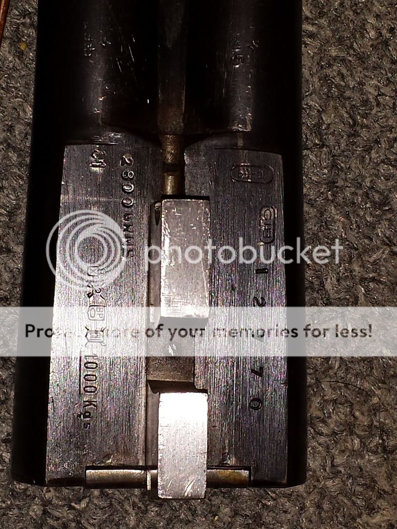

Underside of barrels are stamped "19.3" on both, some proof marks and "1000kgs

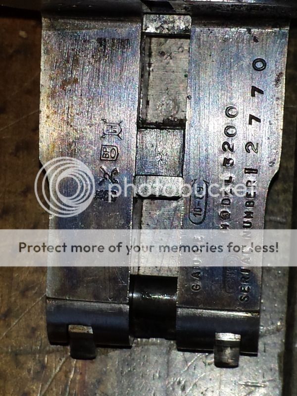

Receiver is marked model 3200, gauge 10-89

The stamp that is circled with 10-89 is intriguing. Everything is metric.
Second photo shows "GUAGE 10-89". Seeing how the chokes are metric I converted the "89", it converts to 3.5, I want to think that is the chamber length. Hopefully someone with knowledge on this style of firearm has seen these markings before.
Chokes too, what does "19.3" convert to for restriction?
I would have preferred the "10-89" to be stamped on the barrel flats rather than on the water table. I would still follow Gunsaholic's advice and measure the chambers.

10-Gauge = Bore Diameter of .775 inches or 19.3mm
F'k I am stupid and should have taken the time to look closer at the pics
It is a
AMERICAN IMPORT CO MODEL 3200 SXS 10 GAUGE
is it not guys
If so should have 3 1/2 chamber 32" barrels and full/full chokes

Also to me is it Spain produced not Italy as you originally stated from the proof marks but the boys will confirm
Check against this
http://www.nramuseum.com/media/940944/proofmarks.pdf
I always thought the BP was smokeless powder approved and the cross gun tested twice but again I'm no sxs guy
Other than some sweet old winchesters :)
I can't quite make it out but if that is a 01 on the left side of the barrel flats at the front, then it was made in 1970. I believe GIB was the maker but I don't know who that was.
Edit--I since found this. However, the GIB is not in a box so it might not be the same maker.
IRAZABAL, JESUS (antes MAXIMO BOLINAGA) G. I. B.

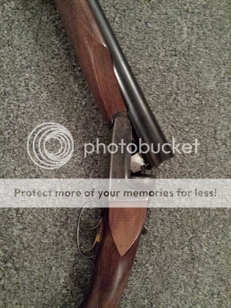

Odd glare, and a testament to my photograpy skills.
It is a "01", knowing the year is cool too, thank you.

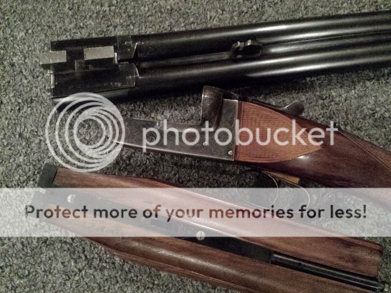

I love the heft of this gun, it is an absolute beast, scale says 11 pounds, 10 oz.
I have an OU I use for fun, but this old SXS is new to me, I can't see myself in a position where I would want to take it hunting, just because of the sheer size of it, but would this be considered a good gun or a knock off of something? While trying to Google every word I could find in hopes of avoiding making a thread I found some on auction sites, averaging about $900, that's not a cheap gun if it is junk. I don't know if that value is because of it's age or if it actually a decent gun. It locks up and functions smooth, especially for something that is 45 years old.

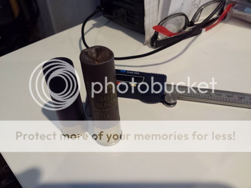

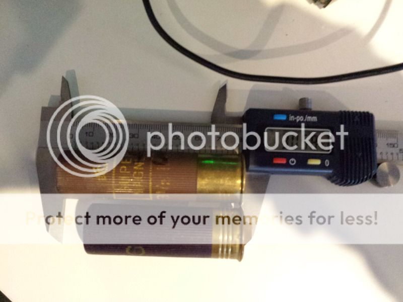

I have a few.
Small shell, unfired is 2.538" unfired.
New shell is 3.048, unfired.
I thought the ".5 more" was for the crimp to unfold.
I am hoping this is a 3.5" gun...
By "new, I mean the box I just bought, by "small" I mean shells I already have.
Thank you by the way..
Like so:
I think you're safe to fire 3 1/2" in it now, but I would NOT fire that particular 3 1/2" shell if you paid me! Looks like somebody's really bad attempt at handloading.
I know. I opened it to see what was in it, it had "CC" on it, wanted to see if it was copper plated. It was there for illustration purposes only.
