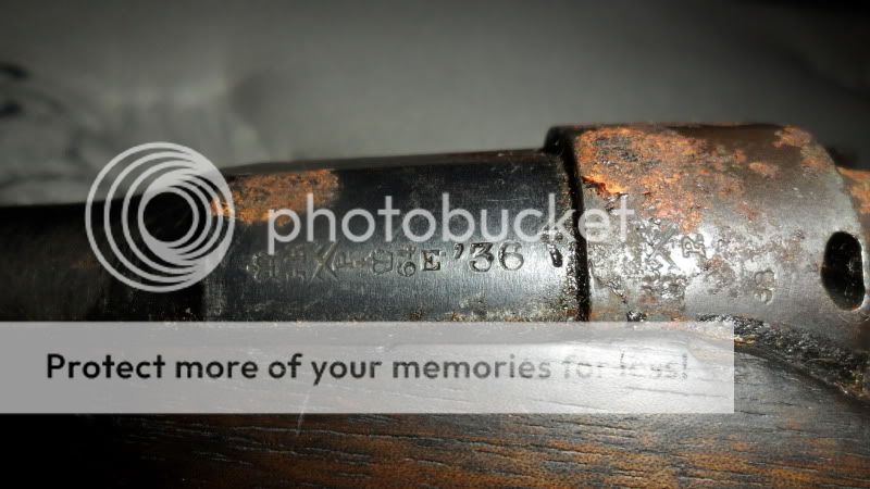

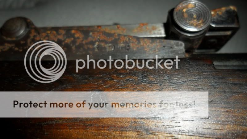

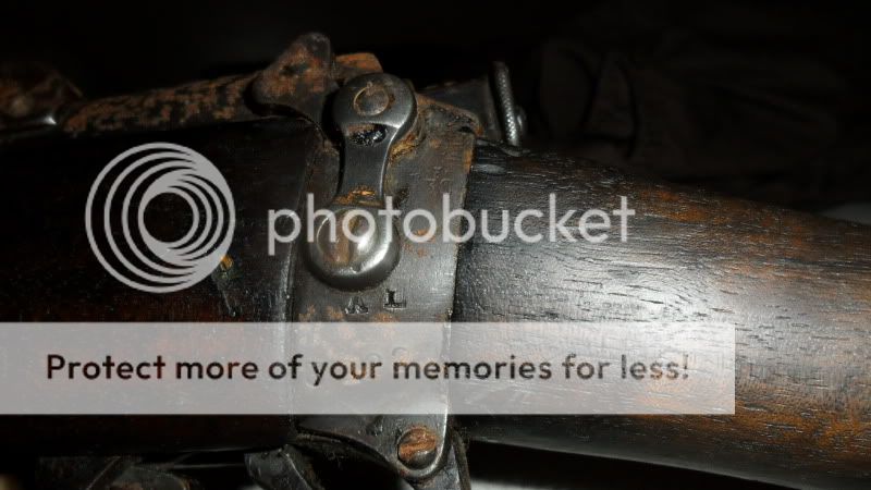

recently came into possesion of this GR enfield 1915, been looking all over the internet and can't find out what the marks on it stand for. the gun needs some work, but its going ot be restored and would love some backround info it.
any help is appreciated
Get that rust off of the poor girl and the rest should be easier to see! Some oil and very very fine steel wool should do it.

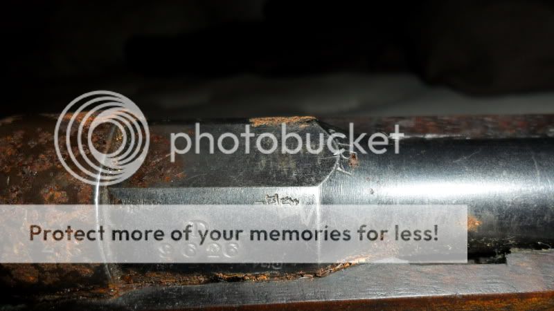

Rebarreled in 1936. Most of the other markings are inspectors marks. Lets have a picture of the right hand side of the butt socket where the date is.
The marking on the front of the chamber is not normal, nor is the serial number on the LEFT side of the butt socket. This rifle has more tales to tell than she's advertising right now. We'll have to puzzle some of them out.
The actual Serial Number still is on the Body (what most folks call the "Receiver") and matches the number on the new (well, it's only 76 years old: very little if it hasn't been shot a lot). The rebarreling was done at Enfield in 1936, so it was done right.
Other parts we can see all are Enfield manufacture.
