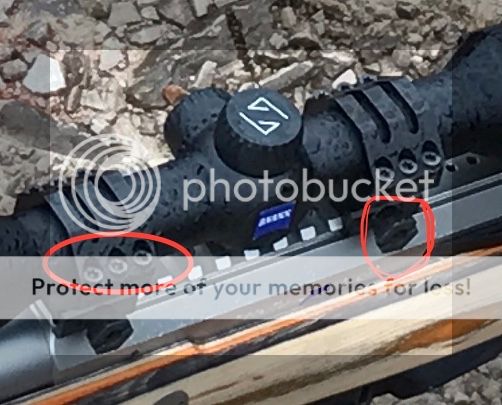

Tarkus Member Rating - 100% 7 0 0 Location Quebec Jun 27, 2018 #1 I forgot the settings in in-lb for the side screws and the top screws for my Zeiss Conquest on a picatinny rail on a Tikka T3 Arctic. Please help, I attach a picture of the whole thing. Thanks.
B Brianma65 CGN Ultra frequent flyer Rating - 100% 197 0 0 Location Canada Jun 27, 2018 #2 What make are the rings? Usually you can find the torque specs on the manufacturer web page
KePet CGN Ultra frequent flyer Super GunNutz Rating - 100% 249 0 0 Location Redneck Central Jun 27, 2018 #4 I think they are 35-45 in/lbs for the crossbolts and 15-18 in/lbs for the ring screws
Tarkus Member Rating - 100% 7 0 0 Location Quebec Jun 27, 2018 #5 I just checked on the Weaver web site, they say 35 in-lb for the crossbolts and 15 for the ring scews. Thanks very much.
