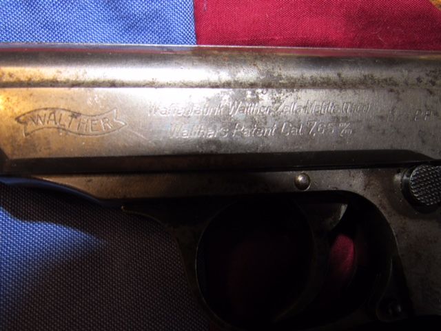

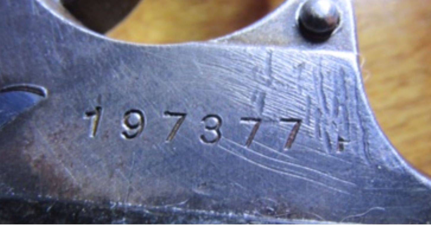

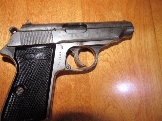

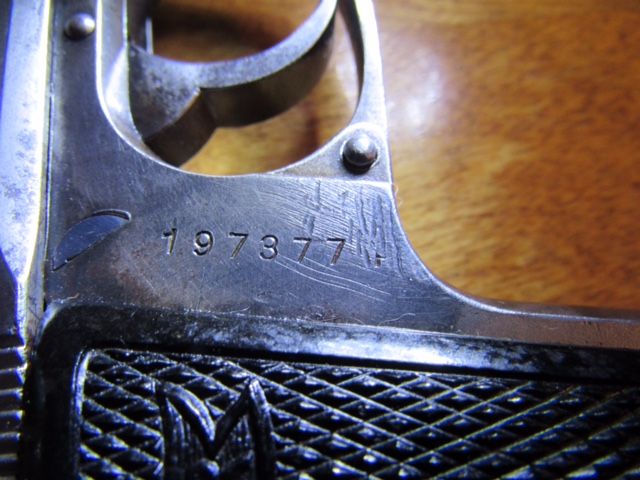

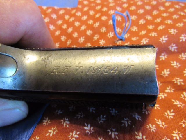

My father has a Walther PP RFV that he is trying to transfer me as a 12.7. To us it is obvious that it is pre-1946 as the serial number dates it to 1940. The issue is that as some point in its life the "P" at the end of serial number was either ground or hammered off. It's hard to see but it is still partially there, but the P is not on the registration. The other side of slide also has "Zella Mehlis (Thur)" on it which, as far as I know, did not produce any firearms after 1946. The RFV (Reich Finance Administration) markings on the grip are consistent with other war-time PP's.
When he originally tried to transfer it to me the CFC stated it was too new and could like be transferred, I assume it is because the "P" is not on the registration and strictly going by make/model/serial # ######(no P) would put it as a post-war. He sent them some pictures and went back and forth but they said it wasn't conclusive and eventually stopped answering his emails.

Your Walther is 100% pre-war. Zella-Mehlis (the manufacturing facility marked on your pistol) was destroyed before the end of the war. All pre-war Walther handguns were made at Zella-Mehlis. My dad has transferred 5 Zella-Mehlis PPKs and PPs to me without issue, so I have no idea what they're thinking on that gun.

I am a ppk/pp collector and as other said, the main factor you gotta take into account when buying one is to check the slide for zella mehlis. This alone mean if was made pre 46.

Personally the serial is strange because I can't find it in the chart. If there was a P, it would mean the gun was made in 1940.
It is possibly a defect during serial number punching. We can see there is a mark where the p should appear.
Take in mind I have also a rfv pp and there is no p and no slide serial (gun was made in 1932)
There is so many possibility and we cant know for sure because the nazi destroyed the archives documents.
Just tell the rcmp the p was improperly stamped. The zella mehlis and rfv marking should be enough to prove it was made before 1946.

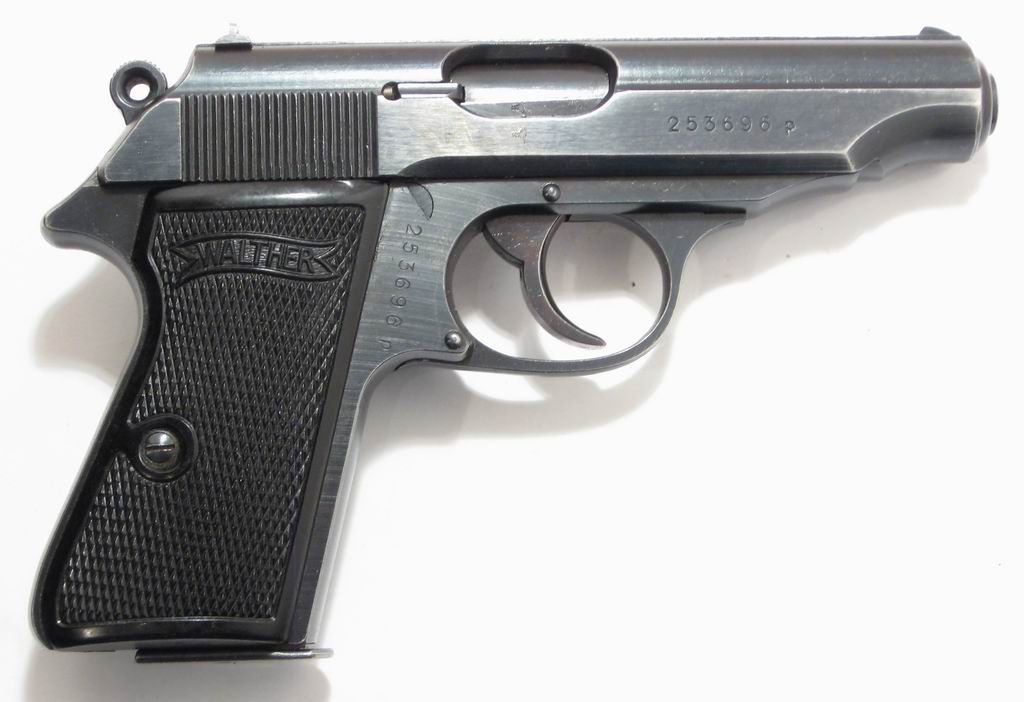

Also if you take an exemple from tague.at
You can see the p is poorly stamped and right where the mark are on your frame.
