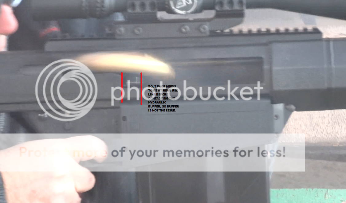

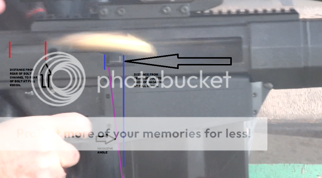

The firearms action is very slick after a workover, but the bolt still short strokes upon. At first I though that the Hydraulic buffer was the culprit, but after close review of high definition video, frame by frame, has determined that the bolt consistantly does not clear the magazine, and does not come close to hitting the start of the hydraulic buffer.

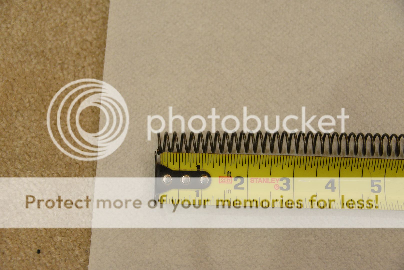

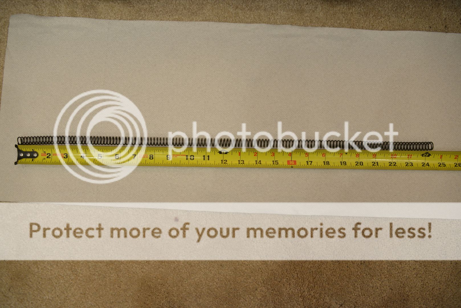

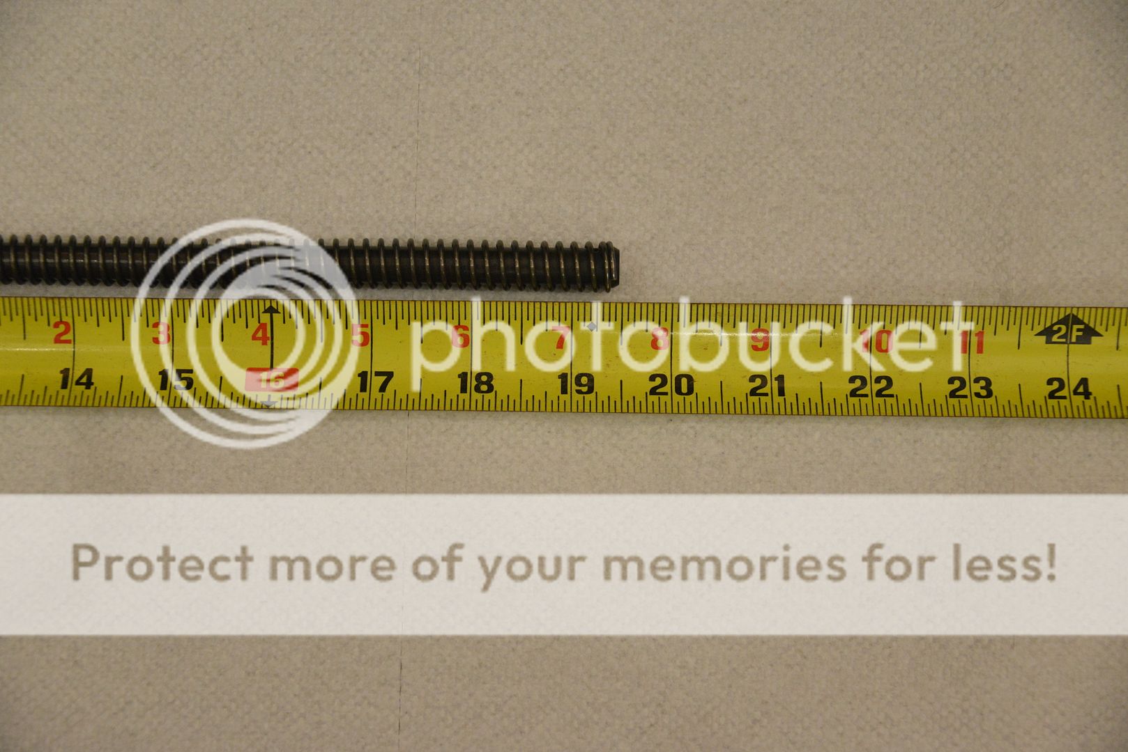

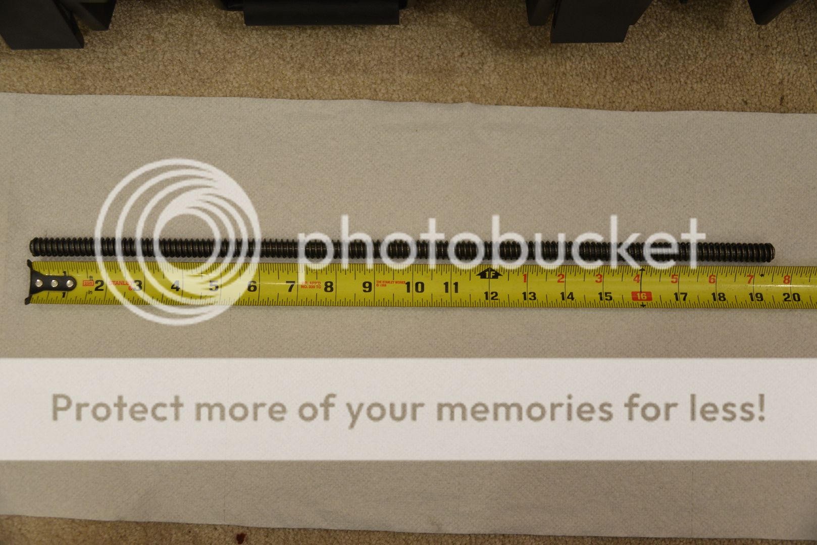

I have the length while under pressure on the guide rod, as well as uncompressed length, and coils per inch of both as measured by a tape measure. I can't find my calipers, but when I do I will get the wire gauge. Anything else I need?
Here is a photo showing the extent of the short stroking, and how far I need to adjust the springs.
Here you can see that the bolt does not even start to contact the hydraulic buffer until the bolt has already cleared the magazine.
Springs, both compressed at full length on guide rod, and full length uncompressed removed from the guide rod.
Uncompressed.
Video of the short stroking. It just barely catches the first round, but fails to catch all subsequent rounds. The bolt stopped at the exact same spot, just shy of clearing the magazine, for the following 9 shots.
