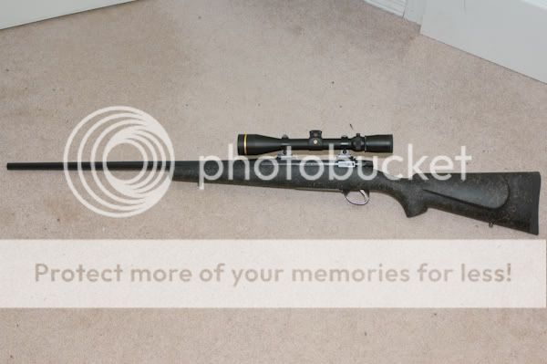

I have been having a problem with this gun.
I have been working up loads for this gun but I keep blowing the bolt and needing to hammer it out every time.
Any ideas why this is happening?
any one have a load for this that works.
Help please
I have had the head space done.
and still the same problem

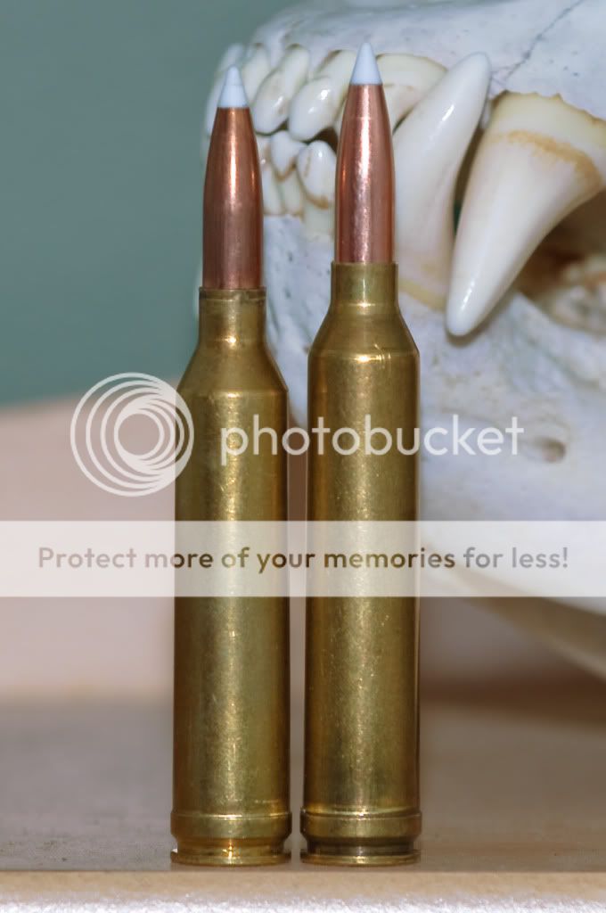

Bullets are not seated out, over .250 jump. Just had a thread taken off and head space corrected. Brass not all scratched when it is extracted. In fact looks good. Browning Mouser 98. Twist 1 in 9. maybe 1in 8. Brass web new .505 fired .513. The throat is not great. the barrel is 27 in.

I've always had new brass measure .512 at the expansion ring? .505 does not seem right?
But if you are .513 after firing, you should be fine as I have had cases come out no problem up to .515 from most of my belted magnums.
