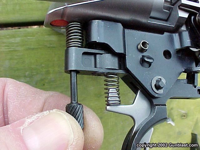

In a Savage Precision Carbine with the accu-trigger what is the part missing from this picture? (Empty hole above the trigger blade)
https://imgur.com/gallery/ZEvXUGX
Is this a safety detent spring or roll pin or??? How do I get a rush replacement? Any links to a supplier? Can this move while shipped without the bolt?
should look like this...
http://www.gunblast.com/images/Savage_AccuTrigger/Mvc-005f.jpg
Thanks!
is it actually a part, or just a lubrication hole for the trigger ?
Grizz
In the second photo it shows the spring coil extending out from the hole and in other pictures it sits more flush with the opening. The safety is not engaging and I am assuming this would provide friction to hold that in place?
It would be more accurate to say that the safety does engage, in all three positions but does not remain in place. .
