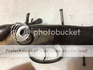

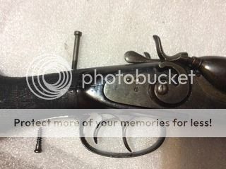

Please see attached picture.
I'm not exactly sure how to remove the butt stock on my Grandfather's old 16ga SxS - American Gun Co., circa 1908..
It is all cracked up at the wrist in atleast 3 places.
I have both the top and bottom tang screws out.
I am also able to remove the one small screw on the side plate, where there is a cluster of 3 fasteners....1 screw and two pins.
Do I need to punch those other two pins out?
I don't want to attempt that if it isn't needed, I have thought they may be related to the trigger assembly but am unsure, better to ask first.
Can I get some tips how to remove this butt stock so I can attempt a repair?
Thanks
First, take out the screw on the left side, then pull off the two locks ( right and left side). They are slightly hooked at the front end so they swing out at the rear to come free. The "pins" are screws so do NOT punch them out.
Then remove the screw that is under the top lever, and one at the front of the trigger guard.
Remove the trigger guard and the stock should come off.

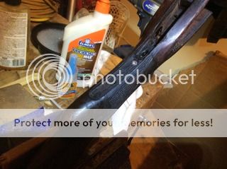

Now I need to figure what is the best glue to use on this stock and if/how I should reinforce it with dowels or pins.
The wood is oily so do I need to prep that first.
Any help would be appreciated.
There is an earlier thread (last post was on December 20th) that discussed various glues to use. Another good resource is doublegunshop.com website. Depending on the type of cracks, you may be able to use "staples" from the inside so the repair is not visible. I have used ZAP CA glue plus staples on hairline cracks with excellent results. Post some pictures of your progress.
Soak the wood in acetone to draw out the soaked in oil.
I like to use epoxy for that type of repair.
Lots of info on the net as to how to a hidden repair.

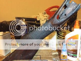

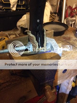

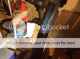

Update
One final crack gluing in the vice right now and I'll have it back together tomorrow night.
I used Elmer's ProBond Max on the main crack. I added a #4 x 1" screw hidden under each tang, predrilled the holes and filled half way with Gorilla Glue.
So far, so good.
