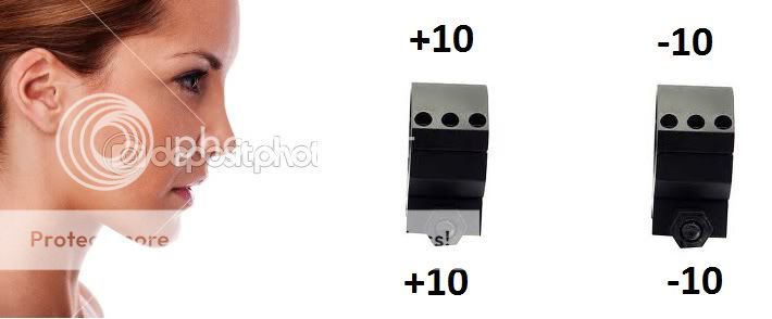

Is this ok?
i have it on two different heights?
+10 on the top and bottom of the rear
and
-10 on the top and bottom of the front
ps. stole the pics off google....shhhh dont tell

+10 on the top and bottom of the rear and -10 on the top and bottom of the front

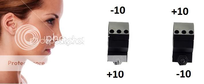

You would do better with +10 on the bottom & -10 on top on the rear.
-10 bottom & +10 on top on the front.
The inserts are designed that a + & - are required on each ring.
^This.
You want to put the +10 on the bottom of the rear ring, and the top of the front ring. Then the -10 on the top of the rear, and bottom of the front.
Then try again.
Is this ok?
and
I am going to hazard a guess that your front ring is loose and the rear one is super tight.
The eccentric inserts should go as follows:
+10 on bottom rear and top front.
-10 on top rear and bottom front
That way the scope is canted up at the back and down at the front

WHAT YOU GUYS ARE SUGGESTING IS THIS CORRECT?
My original fired set-up was 0's all around.
My new set-up which I showed you was what I found to give me the closest 0 using the Bushnell bore sighter.
