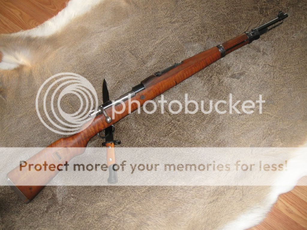

Sounds like a possible Yugo M48BO.
If you had a chance to view the rifle in person, does she look like this ?
(Image borrowed from google)

x2 on the Yugo M48BO
The M48BO has a stamped plate at the bottom of the receiver. It comes with all accessories from Marstar for $479.

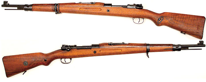

With that straight bolt handle in mind, she may be a refurbed VZ-24 that was sold as surplus. We don't know if she ended up in Egypt but it is a possibility.
Does she look close to this ?
(Borrowed from google once again)

Nabs the rifle pictured looks very similar.
