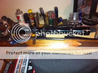

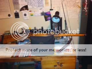

pics up
So is this a good rifle, shooter, collecter?
Dependant on how it has been treated during the last 45 years it should be a fair shooter - it's not a collector - and will be able to kill anything you point it at.
Current market value would be somewhere between $350.00 & $500.00 which is a shame as it is better built than many other rifles selling for twice that price.
