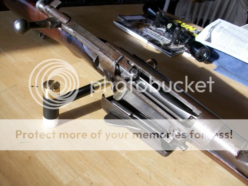

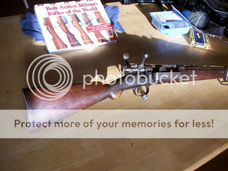

I've a sportered Springfield armoury manufactured Krag, it's awesome
[/URL]
Slicker than Catsh*t on a linoleum floor. Tired old rifle, but a great bore.
