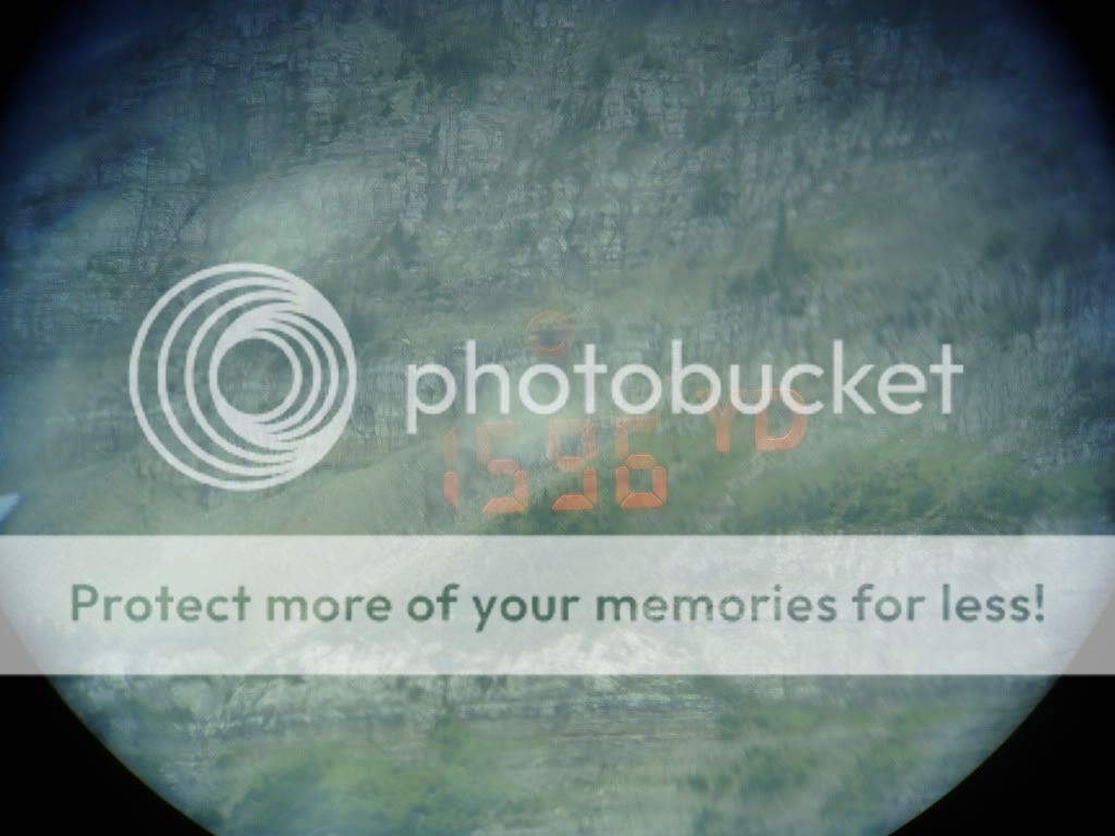

This fall I got a Swarovski 1500. It will range darn near anything out past 1500. I have relaibly ranged a variety of critters out to about 700 yards so far and it seems likely it will work on hair up to 1000 yards. As well, the glass is incredibly clear and bright.
FWIW I would hold off on the entry level rangefinders and save up for a Zeiss, Leica, or Swaro.
Here is a pic from my Swarovski 1500 on a rock face. I have also had it range farther but was not quick enough to take a picture before the reading cleared.
