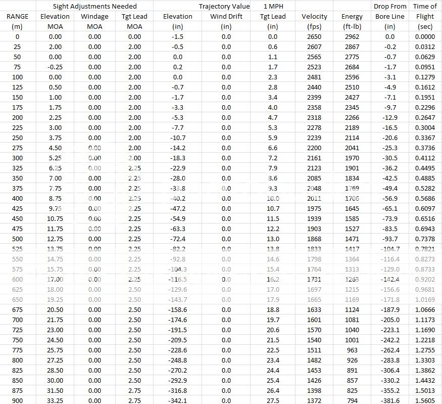

Chrono is down to be able to plug into JBMs calculator. I have the zero for 200yds and .9 mil up puts me on at 300yds and 1.8 mils up puts me on at 400yds.
Can anyone with just those numbers give me come ups every 50 yds from 200-1000 yds. It would save this old man one helluva lot of walking.

I have taken a SWAG at your velocity at 2650 fps. Based on the G1 BC for the bullet, I ran it through EXBAL and got the following. It is in Minutes of angle, so you will have to do the conversion, but this will be close.
I came up with a muzzle velocity of 2525 FPS. Reverse engineering his numbers came the closest to this velocity. Sorry but I am not converting your drops into mils, doing the math do convert your mils into MOA was pain enough for tonight. :)
Max Point blank range is 257 yds when zeroed at 218 yds.

Thank you very much fella's it is much appreciated. This saves me a great deal of walking back out to the targets after shooting a group. Then going back to start all over again to fine tune. Saves bullets, Time,awhole lot of walking and just a wee bit of foul laguage.
