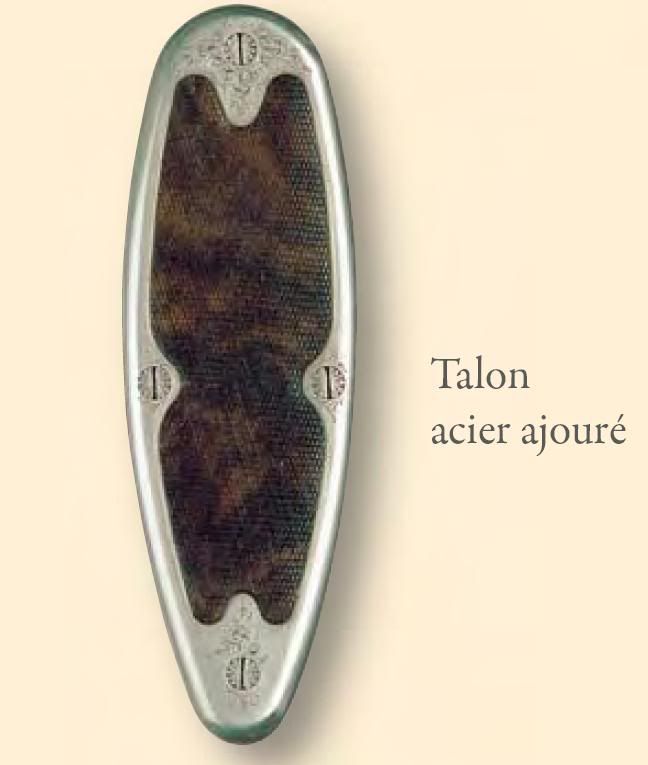

I know for instance the last one is a Skeleton Butt Plate, but I want to be sure that's what there calling it in the catalog

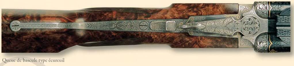

Translator said this one was a "Squirrel Tail" Whatever the proper term, it refers to the metal that runs through the grip and up into the comb (seen in the next 3 pix)

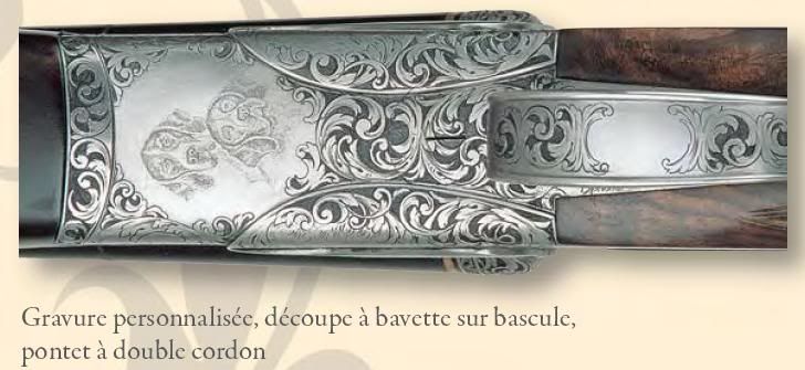

I *think* this refers to "you can get personalized pictures engraved"?

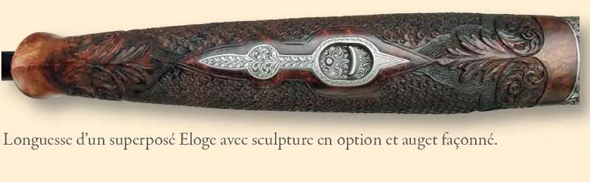

Again, no idea, wood sculpting perhaps?

But I want to know what the proper term for the metal that flows from the safety to the middle of the comb on the top, and from the trigger guard to the middle on the bottom, I haven't seen that on another rifle yet. I like it.

1- squirl type receiver/action tail (or squirl tail tang?)

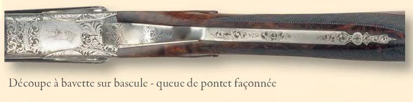

3- Bib cut on receiver. Custom trigger guard tail.
4- Personalized engraving. Bib cut on receiver . Double lace trigger guard.

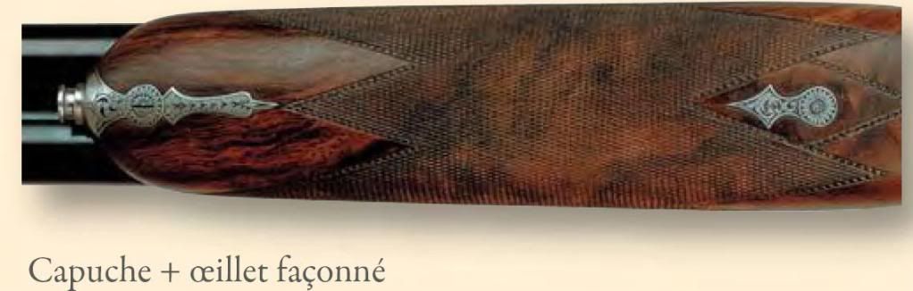

5- Custom cap and inlay.
6- Forearm of an Éloge O/U with optional sculpture and custom auget (I guess that is the disassembly lever).

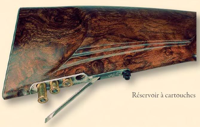

7- Cartridge reserve.
8- Steel ,skeleton butt plate.

Most North American makers would simply refer to "extended top tang" and "beaded trigger guard" for a couple of them. Both features nicely done in those examples. A lot of craftsmanship exhibited there although few of us on this side of the pond would chose some of the features presented. The wood alone is knock out quality.
