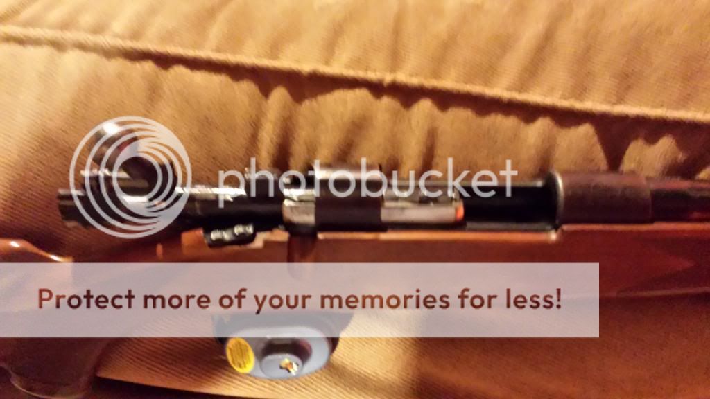

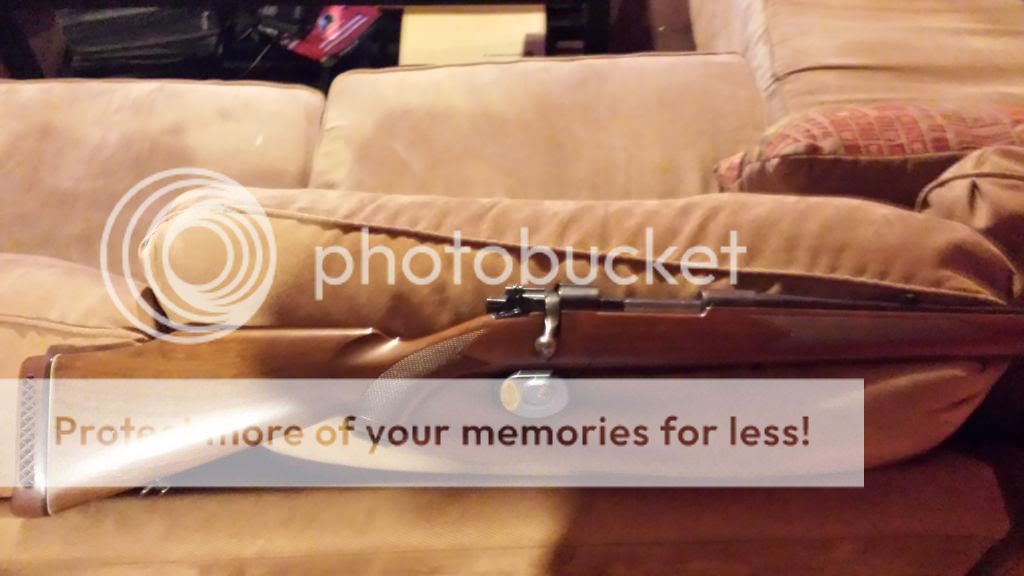

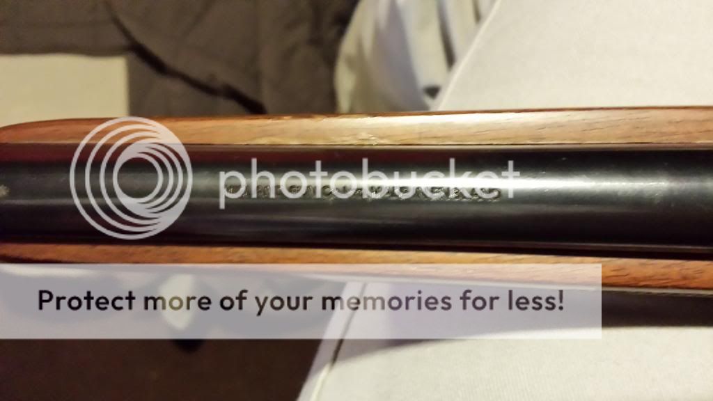

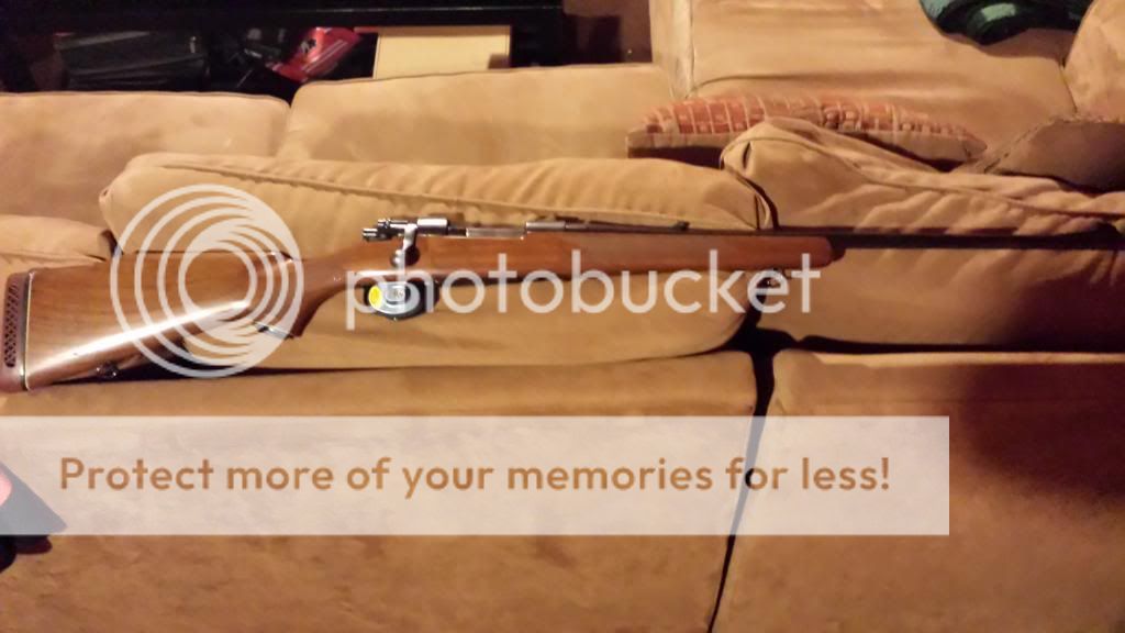

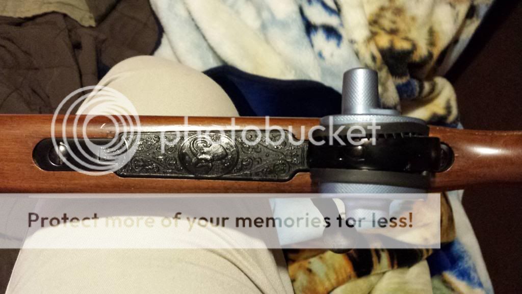

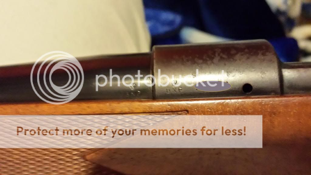

I need some help identifying the model of a rifle I just purchased off my uncle. It has Midland Gun Co. made in England on it and a BNP with a tiny crown near the serial number.
Doing my own research I have found that Midland Gun Co. was purchased by Parker Hale. Judging by pictures I have seen, I have came to the conclusion it is a Model 1200 but I would like some confirmation. I am also looking for scope mounts so I would like to confirm the model before picking some up.
Yes, it is a Midland 2100.
It is not a Parker Hale 1200.
The 1200 was a rifle made up generally using a commercial sporting Mauser 98 style action.
The 2100 Midland used a unique action assembled on a cast receiver with a military surplus 1903A3 Springfield bolt, along with a number of already available parts.
At the time both rifles were in production, the 2100 sold for significantly less than the 1200. The 2100 was PH's economy rifle.
As stated its a Midland 2100. Scope mounts bases are the same as the Parker Hale 1200. Any bases made for a commercial model 98 mauser action will fit.

No, a 2100 does not use the same bases as a PH1200. The 2100 rear receiver bridge is larger in diameter, to clear the Springfield safety lug. PH made bases for these rifles, to accept PH rings. For a time, Weaver made bases, accepting the standard Weaver ring system. The PH1200 uses standard FN sporting Mauser action bases.
