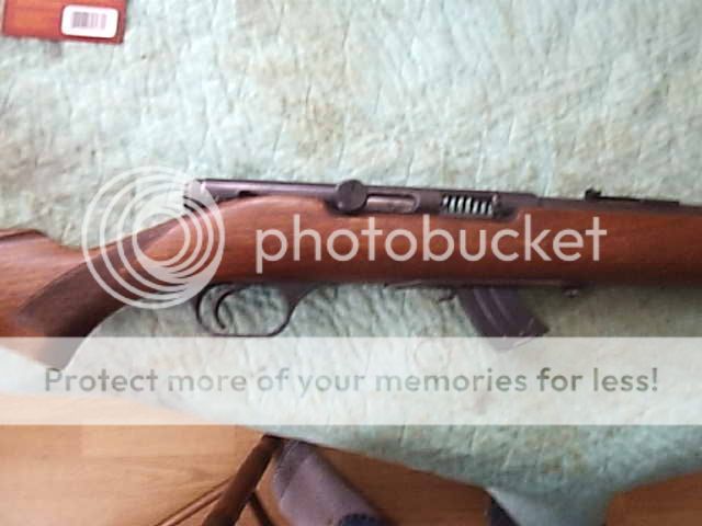

I picked up a new to me .22 rifle today and haven't had a whole lot of luck finding info on it. Specifically I would like to find out how to disassemble the bolt and where to order parts, somehow the extractor was totally sheared off and I want to repair it. The only markings are:

I took photos last night but it got a little late for me to upload them... Here are photos of both sides of the receiver.
It is a semi with a box mag.

It looks a lot like the Savage 7H to me and by a picture of the exploded 7H the parts look like they may be interchangeable...

Certainly a gill gun, and looks like an early style.
These are nifty rifles, and were made in large numbers. Not all parts are interchangeable though, as they went through some changes. You will have to do a touch of detective work to pin it down. The swooping hook of your trigger, shell deflector, and number of gills can help pin down exactly what it is. Buffer, and trigger group will help too.
Neat gem that you'll appreciate! The bolt doesn't close until you release the trigger (hence the distinctive clakety-clack), and you can press the charger handle in to lock the bolt (making it a straight-pull bolt action). These are pretty darn accurate semi's.

I really liked the overall look of the rifle but when I got to looking at it and noticed the charging handle "selector" I was really interested. For a $40 acquisition I think it'll be some fun to play with as soon as I can bring it back to life!
