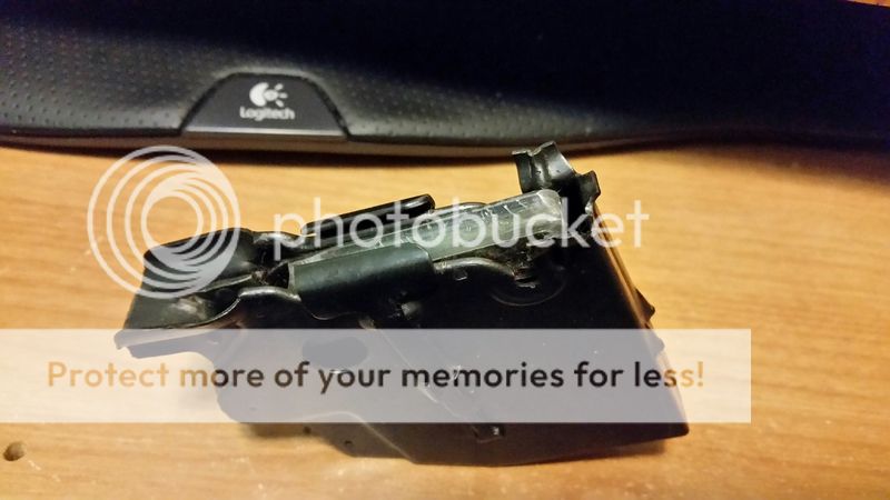

Now that I can observe the two parts seperately, the first thing that I notice is the rear of the magazine well. I will wildly let myself to propose that this part shouldn't look all buggered up like this?

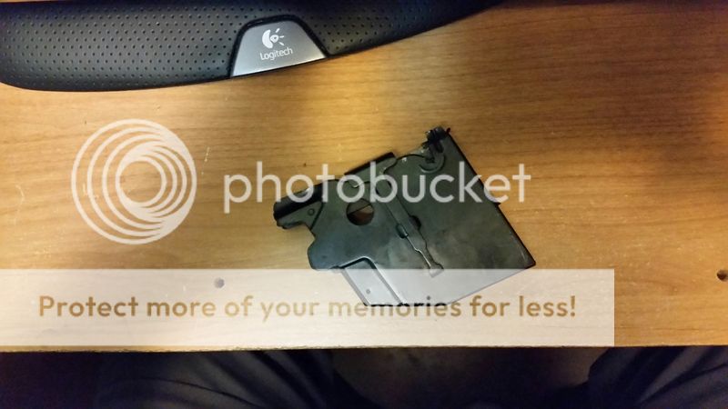

Got the mag well out. And, going even more onto slipery ice, I'll suggest that the magazine box, once removed, allows me to see some damage which will require some repair?
Anyone can send me a picture of what this should look like if it was in good shape? I probably will have to weld and shape some sheet metal...
