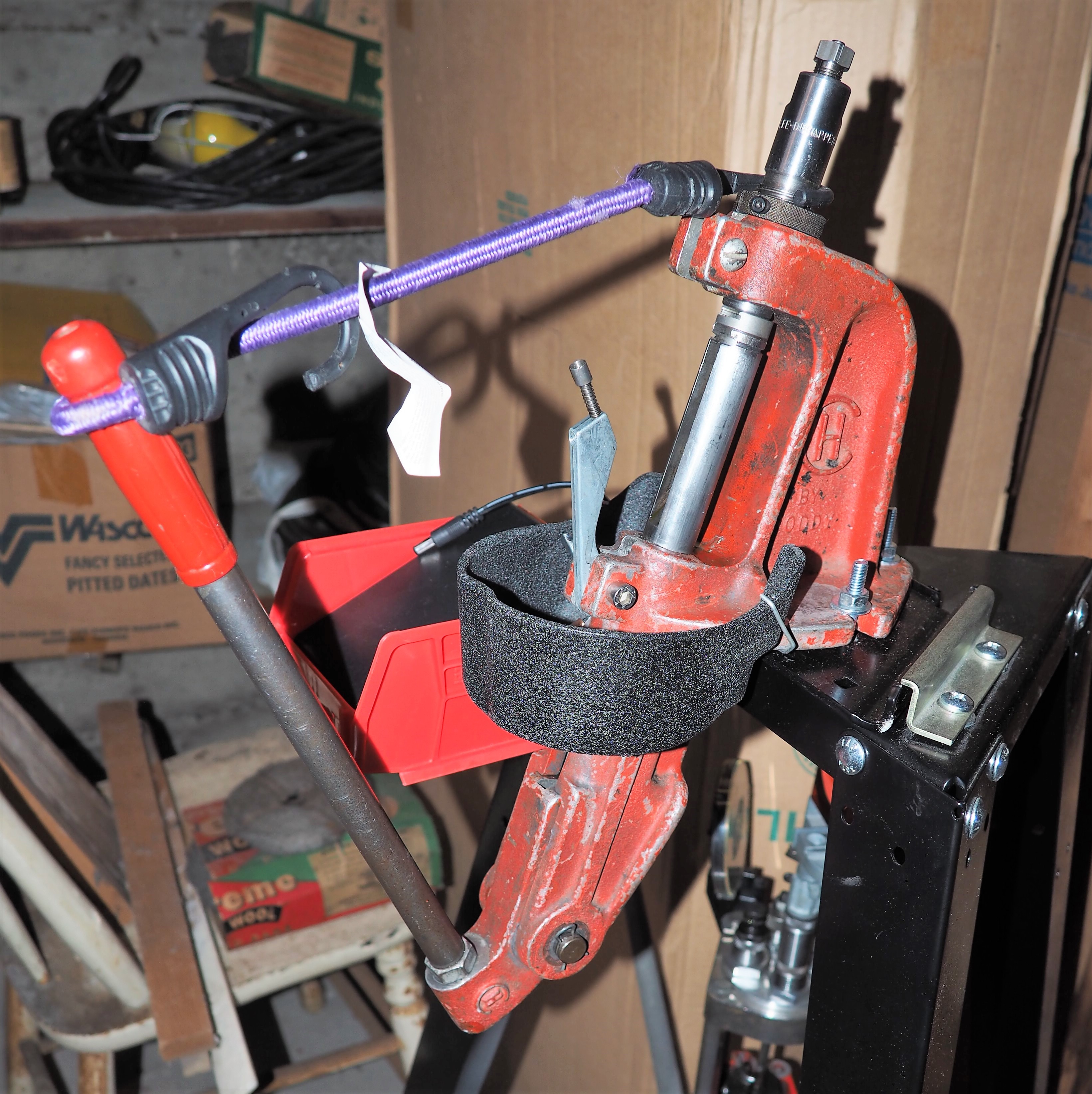

Hey Diopter,
Looks like a good setup you have (I like the bungie cord :)). Are you running an adapter of some kind or a CH specific shell holder on your press ?

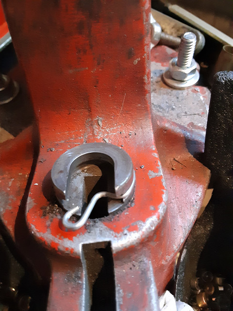

No, just a spring clip to keep the shell holder in. Above picture does not have it. May have a spare laying around.
Will post more recent picture later when I can.
Bungee cord keeps my shins from getting bruised!
Since bought a roller handle for an RCBS Junior handle from Inline Fabrication.
Dave at CH4d should have old spare parts.

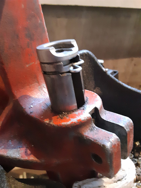

This is the top of the ram with the clip to hold a regular shellholder.
Not 100% yours is the same, but I had a CH press that looked like that. It used proprietary C&H shell holders OR you could get an adapter that would allow the use of regular (LEE, RCBS, etc) universal shell holders. The adaptor is shown in Diopter's photos.
It's also possible sometimes to find the old C&H proprietary shell holders on ebay but there is no reference chart to say which number is for what cartridge, and that makes it tough.
This looks like it could be the correct universal adaptor: here

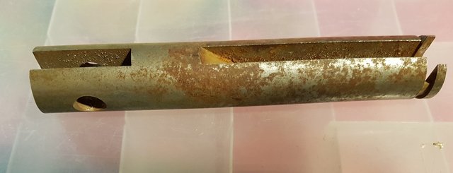

It almost looks like a caliber specific ram with the beveled top edge of the opening.
If a shell holder can slide in then it wouldn't be hard to cut a groove around it and a smaller key ring can be cut and used to lock the shell holder in place.
If not then you need another ram.
There are adapters for the old J-style shell holders but they will not fit on yours.
I have a ram for an older press here, don't know for what brand / model but if it would fit yours you can have it.
Its a bit rusty but that will clean up. Its never used actually.

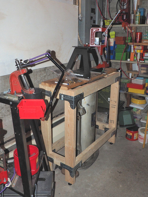

I am presently working on cleaning up the press, it looks like it sat around someone's garage for sometime. I can't wait to start using it :). On that note, is that you setup in the video, diopter ? If so, what stand are you using ? I am looking at options to mount mine that are sturdy but won't break the bank and be somewhat mobile or can be disassembled.

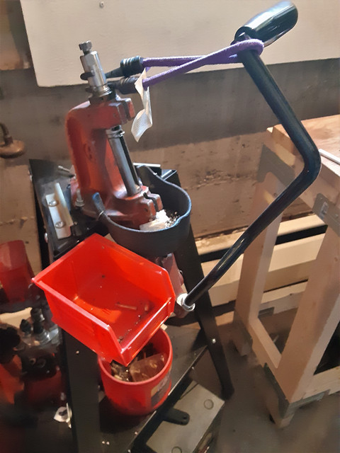

My CH press is shown on a Lee Reloading stand. Don't bother with the Lee wooden blocks, they crack along the grain. Should have been decent grade plywood instead.
Get the steel plates and drill the holes you need. The plates are pre-drilled for LEE presses.
Other Setup is 2x4's with Simpsons Strong Tie Brackets to support an oak thread on top of a old steel Oliver Stringing machine, which was too wobbly by itself for FL Resizing rifle brass.
The Inline Fabrication mount is great for switching presses quickly.
Added leveling feet and lock nuts.
Hornady LNL AP and RCBS RC+ PiggyBack on Inline Fabrication 2 press dock

Nabs Bertha is correct you have a cartridge specific ram in that press. CH will sell you a new ram ram that accepts the snap in shellholders. What you want is a CH part #412090. They run about $30. Hope that helps
So you're making 6.5x58 Portuguese out of 270Win?
You guessed it. The brass is reformed 270 Winchester for 6.5x58 and they work beautifully.
Hi rokoro, thank you for the parts number, I was looking at that ram and I was wondering if I needed an adapter for that one to accept snap in shell holders. I think I will get that ram as I have some reloading ambitions for an 1886 Kropatschek :).
