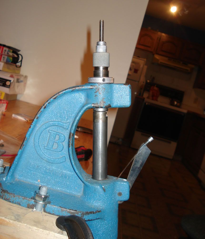

I'm trying to reload some .308 with my new setup.
I'm trying to neck size some once fired brass.
I'm attempting to use the nickle trick to neck size except the shell holder runs up into the threads on the top of the press and the nickle won't fit. I set the die depth, set the lock ring, unscrewed the die until the nickle fit in under the lock ring and then I screwed the lock ring down tight to the top of the press.

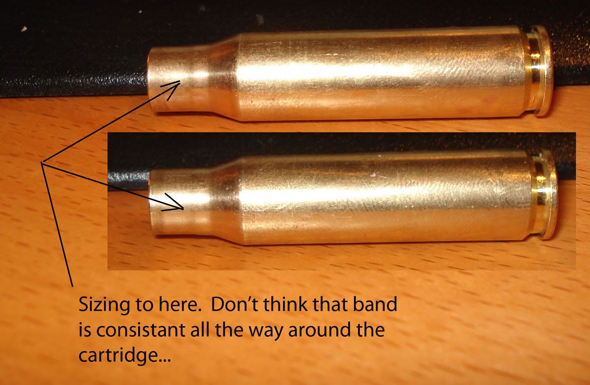

I lubed up my brass on the outside, no lube inside the neck. I rolled it across a piece of high density foam with some Lee resizing lubricant on it.
It seems like it take a lot of pressure to run this brass through the die though I don't know how much pressure is normal....?
The brass comes out and it looks like the neck has be sized down and stops about 1/8" from the shoulder. I don't thing the shoulder is being touched though I get the feeling that the body of the brass is being sized.... is this normal? Should it be getting sized when I'm neck sizing?
I've done 6 pieces of brass but I'm not don't any more until I find out I'm doing things right.
Could this be a problem with my press?
