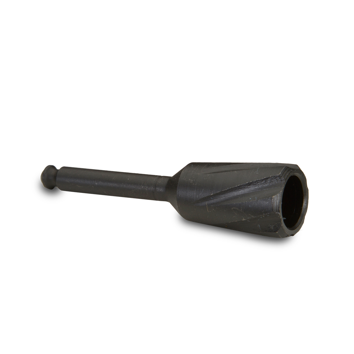

I got this one from Brownells. It's made by Nordic Components. It's oversized but not comically so like the GG&G is. Not only is it a good size but the shape places your finger further away from the receiver which eliminates the chance of snags. Recommended.
