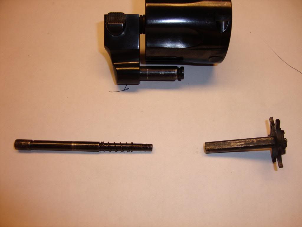

Okay, I took a pic of my RB, when you try and unthread the ejector rod from the ejector, you said it just spins, but is it just the rod that is spinning or is the ejector (part on right in pic) also spinning in the cylinder??
@09outlander - That's nice of you to take time to take the gun apart and add some pics.
I thank you on behalf of the OP :)
