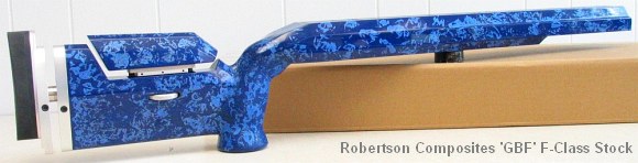

www.robertsoncomposites.com
GBF F-Class stock.
Haven't got to lay behind one but I have fondled and drooled on them.

I agree the Robertson GBF-F is outstanding, I used mine for my first F-class season this year, it was great.

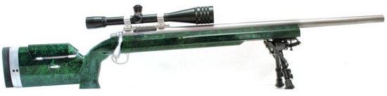

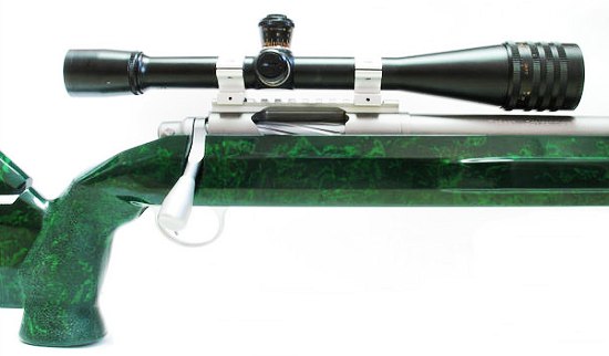

Here it is below...
MMMMMMMMMMMMMMMM........giving me wood!!!
Barnard, GBF, Nightforce and what looks to be a straight blank barrel!!!! Tell me it's not in 6BR.
I need to go find a safe place now to :jerkit:
No, it is 25-243AI, it shoots Berger 115gn at 3200fps...
This was its first year, I have a lot of learning to do ..
