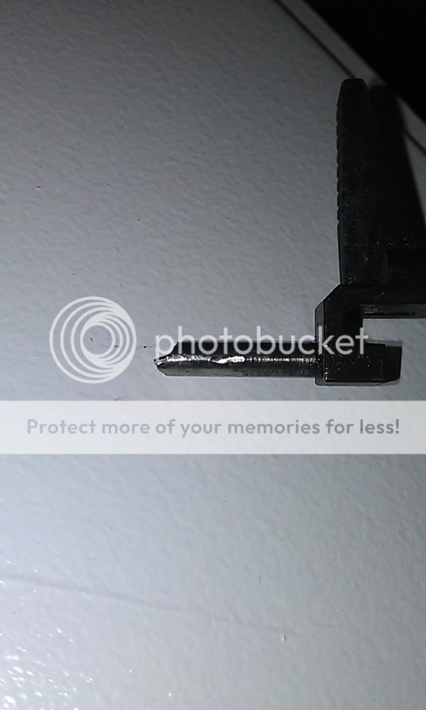

Anyone having issues with theirs?
I bought 2 of them a while back but never really put any range time on the rifles until recently.
Neither of them catch the bolt when the mag is empty now. After close inspection, the metal seems to be wearing into a ramp shape that lets the bolt slide off with the slightest bump.
This happened on both of my CZs.
Trouble shooting: Tried to file the botl catch down to a flat surface again... It worked again for another 5-6 mag changes then started to wear down into the ramp shape.
Is this a common problem? Is there a fix?
Thanks.
You must have an old version as I thought Dave has corrected this issue?
I to have had the same issue also. I switch over to the B.C. Tactical version and have not had 1 issue since.
