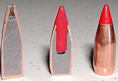

My concern lies with the base, as those photos show theres a solid base on that particular round that remains and might contain enough striations for comparison testing... the entire bullet not needing to be reconstructed.
Im wondering if the small ammo makes a difference since 17HMR is high velocity (2300 to 2600fps) the energy would be huge on a tiny round... and the base would be small...
A 20 grain Remington fireball is cruising at about 4000fps with basically the same bullet as an HMR. And they have a copper jacket where the base is pretty much the same thickness as the wall.
Google ".17 bullet cross section" under images. Now imagine the hydrological effect of that hitting tissue at 4000fps.
ok so even at 2500fps, that should really disappear on impact into a cloud of s**t.
seems the show might have had something... because they specified SMALL calibre. and large calibres have a solid base that remains.
I didnt realize the 17HMR base was the same thickness as the wall
Infact many, if not most rifle bullets have a jacket the same as the .17 with no thick base. It is a matter of velocity and mass. The less mass and higher the velocity, the less remains intact when the bullet hits hydrologic resistance. Other variables like tips and hollow points play a factor also, as that tiny plastic tip in the .17 v-max is literally designed to push through the bullet on impact, causing violent expansion of the bullet.

The bullet you tested looks to be a 62gr or heavier 224. That's hardly what I'd call Frangible. If you want to try a conventional bullet try something like a 36 or 40gr VMAX.
Then of course there are the true frangibles made out of a compressed copper powder. Those leave nothing but dust behind.
If driven fast enough and hitting a solid enough surface/material any bullet will fragmentate. That doesnt make it frangible ammo. 5.56 NATO will usually fragmentate in the human body inside 125 yds but past that fragmentation is less likely. It is not frangible. Nosler's Ballistic Tip Lead-Free varmint bullet is frangible h ttp://www.nosler.com/Bullets/Ballistic-Tip-Lead-Free.aspx watch the video on that page and check out the ballistic gelatin shots at the top of the page. It is designed to break up into tiny pieces and will not leave much behind that shows consistent engraving.

You can definitely consider 17 caliber V-Max ammo frangible... our experience with 17 HMR V-Max through a cardboard box is that it shreds apart... the casing is in multiple tiny pieces the poly tips separate... but... I have noticed striations on the small bits of casing... whether those bits could be reassembled and then compared to a known source... I highly doubt it... at least not with any kind of admissable certainty. And remember... we were shooting through two layers of cardboard... if the target is of a denser material (flesh & bone), I would expect the V-Max projectile to shred to a greater degree. The shredding that occurs would logically be less with HM2 since it shoots at a lower velocity... all else being equal.
