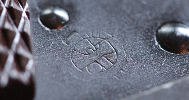

I decided to add this photo also, it's from my 1944 GHD Colt, if the pistol is suppose to have the Crossed Cannon final inspection mark, it should look nice and sharp like this:
