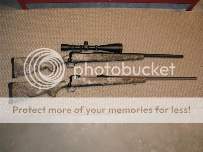

Two Savages
The top rifle is a Savage Predator Hunter Max 1 in .223 and the new build is on the bottom. I'm scope poor right now so the .223 donated the Sightron Big Sky II 6-20 to it's bigger brother.

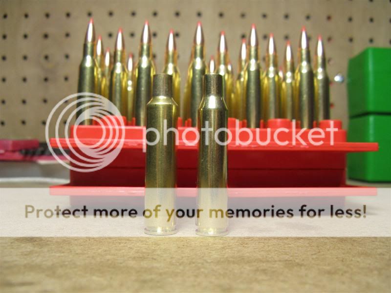

Fire formed brass
I'm using Winchester .257 Roberts +P brass with Winchester magnum primers and 46.0gr H335 for an estimated 3600fps. My chrony is kaput for some reason so I don't have any firm numbers. Hodgdon lists this load @ 3548fps without the magnum primer.

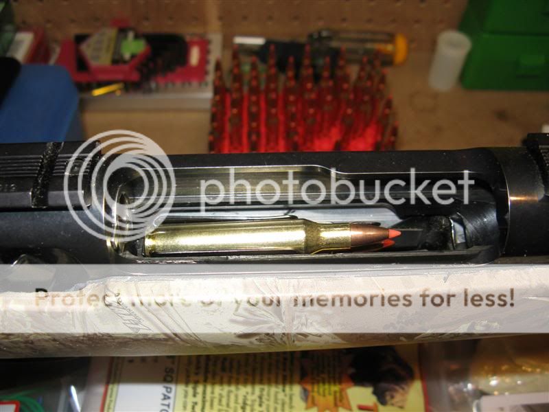

Long action
I'm not sure where the final bullet seating will end up but it looks like I have plenty of room and then some. It also gives me different caliber options down the road if I choose to go that route.

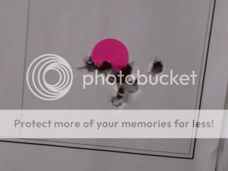

On paper
Crappy cell phone pic of a 10 shot group @ 110 yards with my fire forming loads. I just cleaned the barrel initially and have 50 rounds through it so far. I fed these rounds one at a time with no waiting between shots and the barrel didn't get very warm at all. So far, so good. I have H4350 and XBR sitting here to try when I go to do some load development. I'm not sure what to use for powder with the 75gr bullets and am welcome to suggestions and/or any recipes anyone may have. Thanks for looking.

Two Savages
Fire formed brass
Long action

On paper
