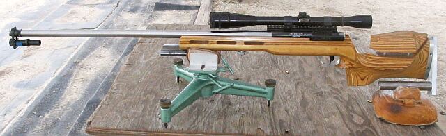

For load development i would go as heavy as possible, nothing wrong with getting behind a 30lbs gun to check the accuracy of handloads.
I made something that attaches to the butt of the gun (out of steel) and added 13 lbs to my guns overall weight and the round bar slides real nice on the rear bag.
Here are a couple of pics of Scott Parkers rifle to illustrate the point
Mercury
Richard, what about a mercury recoil absorber. Check them out on Brownells web site. They only weigh a few ounces and apparently work. Thinking of this for my RUM build.
