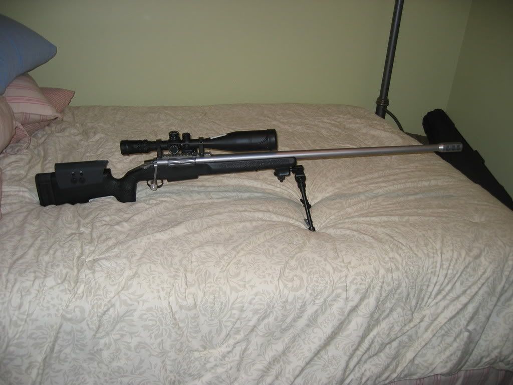

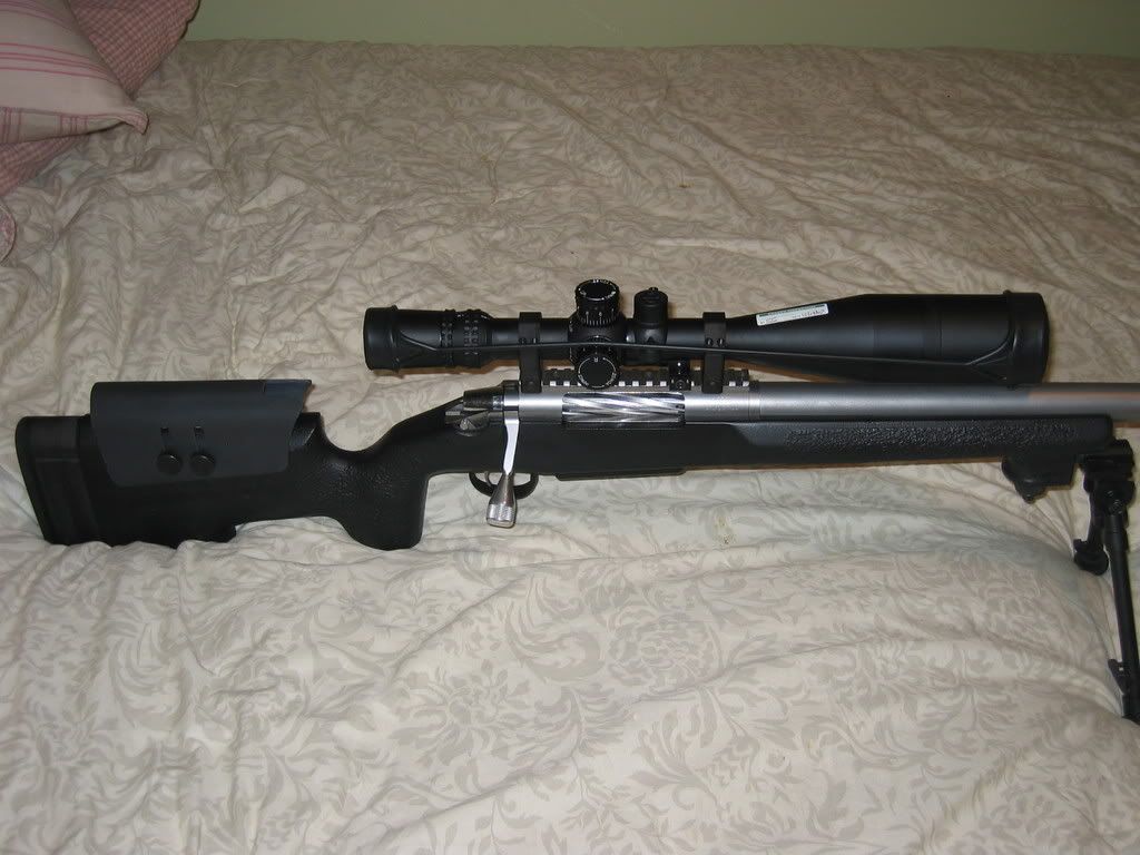

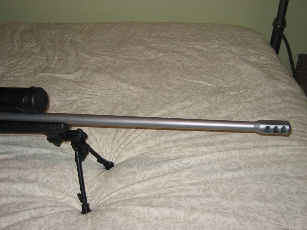

.338AI loads
I have the load already, Rick and I do believe Glock have done the work for me already, i bought this turnkey, with petload data and all....Picked up powder and 500 300smks on the weekend along with the rifle...

The pet load is for this exact rifle, rick did all the work on this rifle (if i am mistaken step in glock) including shooting it, as glock said
"This particular rifle was build with even the length of barrel taken into close consideration and tested in increments to achieve the results it has."
Rick has already done the testing for loads, it came with fireformed/fired brass,even some loaded rounds, the whole works, he took off his 8x32 nightforce and i put a brand new one on.....In fact i do believe he took this rifle to a shoot against some accuracy international rifles......
Took some of the guesswork out for me.....
