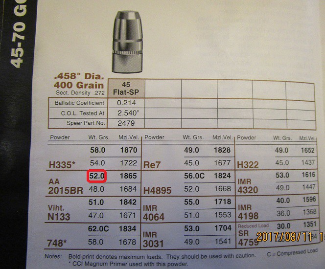

The Speer Reloading Manual states their load data doesn't exceed the industry standard working pressure of 28,000 CUP for new Marlin 1895 rifles. I thought it would be interesting to calculate the estimated safe operating chamber pressure of this rifle for reference and illustrative purposes only (not for design).
