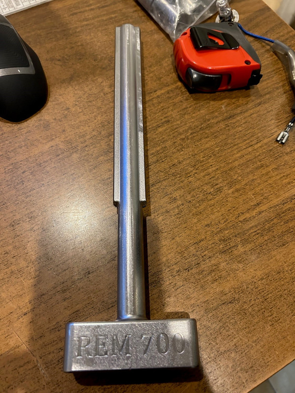

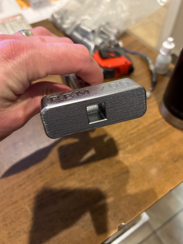

What grade of steel was it made from??
Very nice job.
I've made up a few that were similar to the one in your picture and finally went with a piece of flat bar made from a leaf spring.
Your wrench should fit most Winchester, Mausers and Remingtons and several others.

I’m just using it to install a new barrel on an a new action that I bought.

Correct. There is a tool that bolts to the bottom of the receiver that keeps the lug aligned while installing the barrel. - dan
As I discovered, that "tool" for aligning a recoil lug onto a Remington 700, does not work on a Remington 788 - that 1/4" action hole is in different place relative to the receiver front edge - as indicated in post above, is easy enough to make one, once you have seen the idea, though.
Not sure if those can be used with an external clamping receiver wrench, though - I had got one that does - someone was quite fussy to modify that receiver clamp - to also hold the recoil lug at same time that it grabbed that receiver. He did that by drilling and tapping a couple holes in the face of the receiver clamp - so edge of screw head bears against side of the recoil lug. Must have been a fussy thing to figure out exactly where to drill that tap hole.
