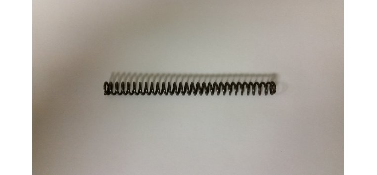

New arrival - Wolff Firing Pin Springs for Zastava M85
Replacement Firing Pin Spring for Zastava M85 7.62x39 Rifles
Stiffer than factory springs.

My M85 doesn't shoot most of the surplus ammo, would it be fixed after replacing the original firing pin string with this one?

Wondering this as well. Would be nice if those that purchased an m85 from you guys would get a replacement spring but don't mind buying it if it will for sure fix the problem.
If you are having issues shooting surplus, please contact us
Was hoping the new spring would be the answer to using surplus or the dominion ammo it came with in the combo... The "please contact us" comment made me wonder if there is more to it than just the spring?
Will be contacting you as a $10 sounds as a great/simple/cheap solution if it works.
V-lad
My M85 shoots surplus (tested 3 kinds) without any issues after replacing the original spring with this wolf spring. Thanks Canada Ammo for bring this in.

All it takes to get M85 to fire the Dominion and Norinco ammo (did not try surplus) is the new firing spring. 40 out of 40 last Saturday.
