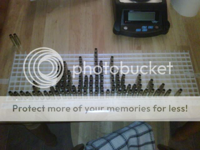

Also, sorting for ULTRA-precise groupings (e.g. for strings intended for ultra-precise group shooting) as below has worked for me:
What you see is a cut piece of fluorescent lighting "grate" (get it from Rona for about $20 bucks, at most - for an entire panel). Cutting it this way, I can "stack" in 0.1 grain increments - which, with about 145gn case weight (if I haven't forgotten) isn't much variation at all.
You can see how sorting then becomes easily accomplished via looking at the "histogram". I label the weights of each column with masking tape and pen, below the grid - so I can keep things straight.
Out of this one, I made 3 major groups of 20-30 cases each; anything "outlying" was tossed in the "plinking" pile and now gets fed through my Norinco M14S. These groups were basically 0.4gn "wide" or so - giving an overall variation of 0.3%. A 1% variation (so, 1.45 grain or so) would comprise most of what you see in that pile - with maybe 10-20 outliers or thereabouts. So, decide how picky you want to be - and hop to it! :)

Also, keep in mind that what I was weight sorting in the pic above was Lake City 2005 brass in 7.62x51... commercial .308 is even tighter, and commercial .223 tighter than that, I find.
