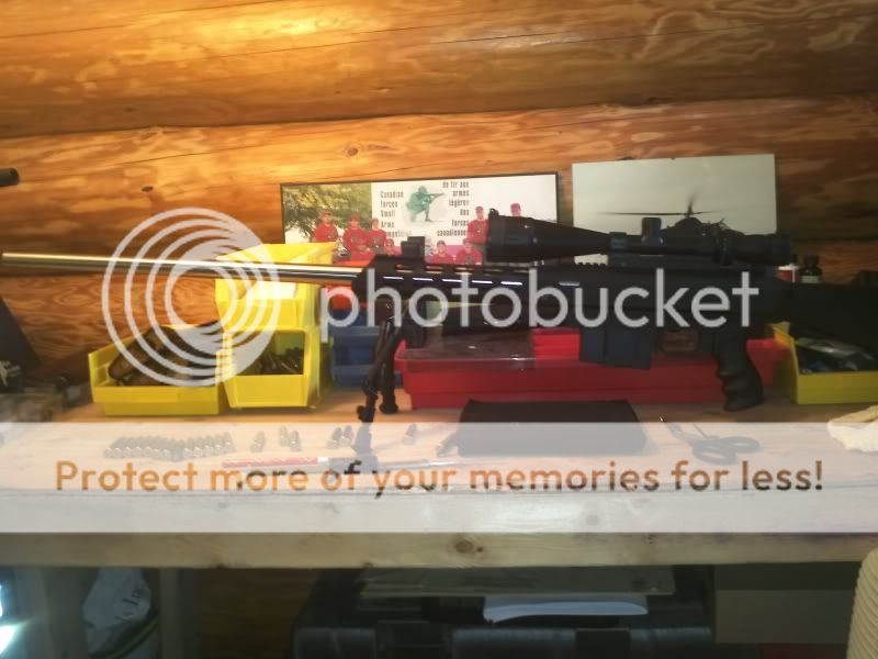

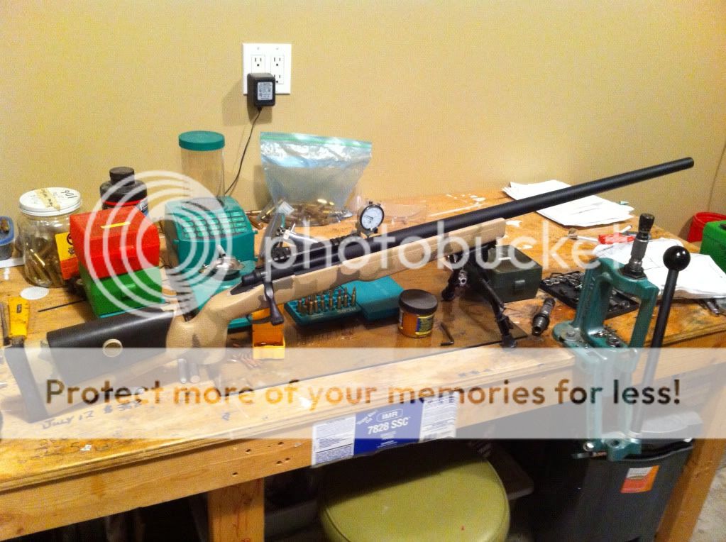

well Just finished this Off ,to the range tomorrow see what I can make it do 32 Inch 1/8.5 Krieger barrel 700 remington action sitting in a MDT long action stock, using matrix balistics 190 gr vld bullets maybe Use it for some F class this year .

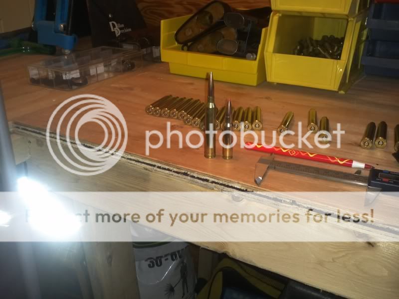

last pic is a 178 gr 308 vmax for size up to the STW
