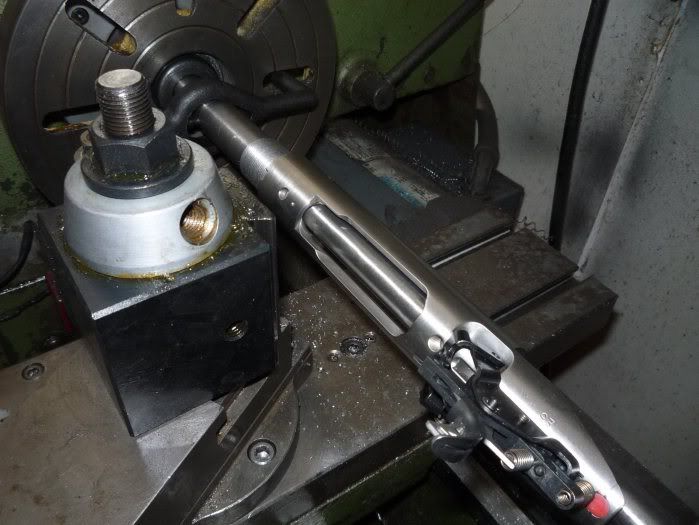

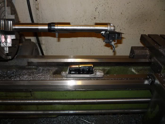

Sounds awesome. Who blue printed the action? Do you have all the parts yet or still getting them together? Any and all pics are gladly appreciated. :)
it is not really a full blue print, simply squaring the action face and bbl nut and he will lap the lugs as well. I apologize for my misunderstanding of the trems. I will get up to speed again I hope!
In the meantime, here are some early pics...
This was an option for a stock till I could afford the XLR, but things came together for me, Can't wait to get it all together!!

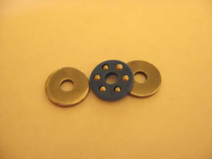

The bearing is a thrust bearing to help withe dreaded savage bolt lift. One of the guys on Savage shooters came up with it. Does nothing to aid in accuracy but helps out with the bolt lift.

does that multi bearing bolt lift kit work any better than the single bearing 38 special case jobbie?

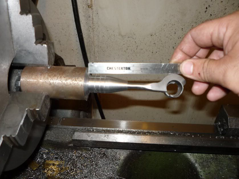

Mark, this is a new oversized bolt handle... I beleive we are doing a re-do in stainless. I origionaly wanted the whole thing flat black, but got talked into action/barrel satin finished stainless in a black XLR chasis.
Sean, thanks for explaining the bearings :D
Can you explain this a little more? Does this go behind the bolt head?
