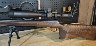

Yes, if you buy online you may get 'nice wood' if the shipping dept doesn't have a buddy that wants 'better wood'. Luck of the draw is right ! I bought my VMTR used on EE, with "a couple hundred rounds fired", but lots of pics b4 buying. I 'washed' the stock several times with Dawn DW-soap, removing a lot of 'colour' until a white cloth came off clean. It came out a couple shades lighter, but NOT the "Mud" that many have received. Then I gave it several coats of MinWax Neutral Floor paste wax - quite durable. The grain isn't 'the best' IMO better than 'straight grain'. Pic below.
As I said there are a bunch of 'plated' FPs losing chrome, posts on RFC show that was common for a 'batch' that came from sub-con I believe was 'the story'. I'd advise taking a wire brush on that FP, maybe on a drill or grinder, to remove as much as possible any loose bits. Then, as I said I put a tiny bit of PTFE grease on the inner bits of the Bolt, including the FP. I've seen 'new' FPs in the USA running $75 or more, but haven't looked here in Can.

Definitely luck of the draw on these stocks. But overall CZ has very nice wood. Some of the varmint stocks have been quite dark recently.
